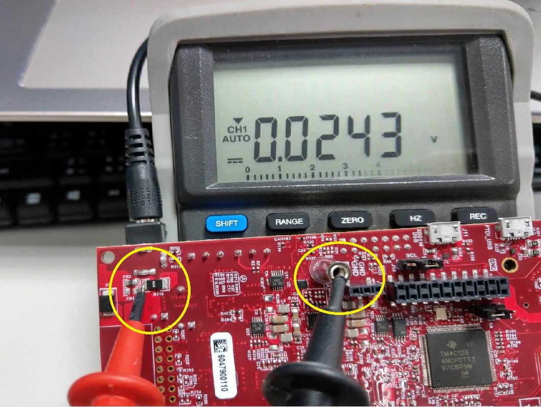

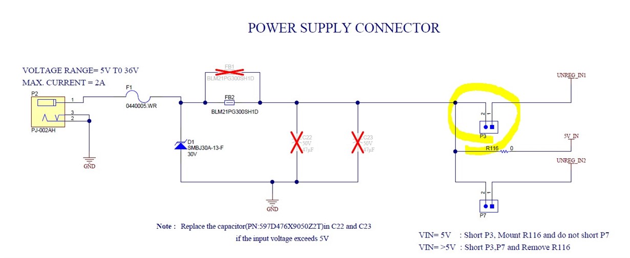

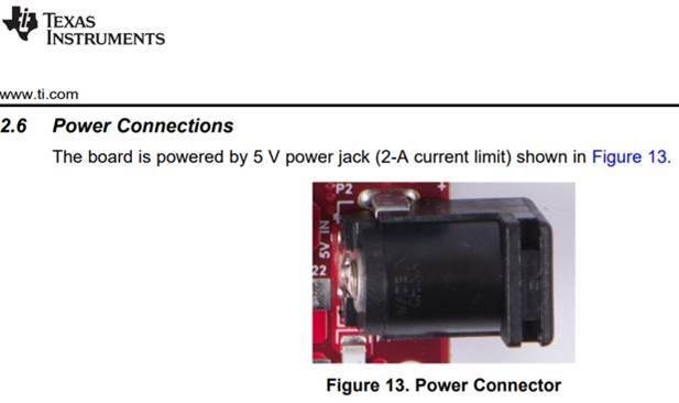

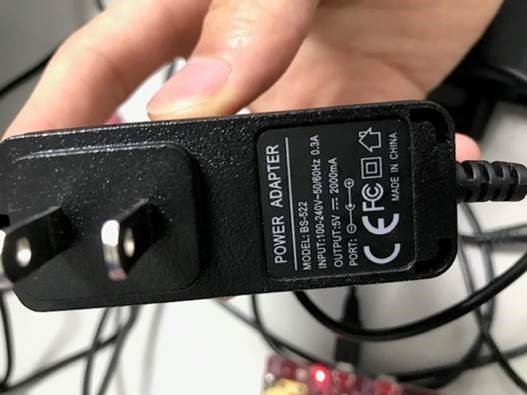

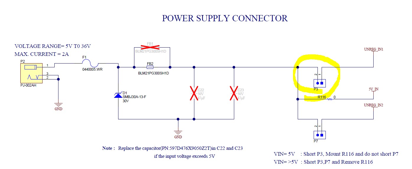

I have bought the MMWAVEICBOOST from MOUSER, When I got the board, I connected the 5V power supply according to the user guide, but it didn't seem to work properly.
it cannot supply power, is there something wrong with my hardware?

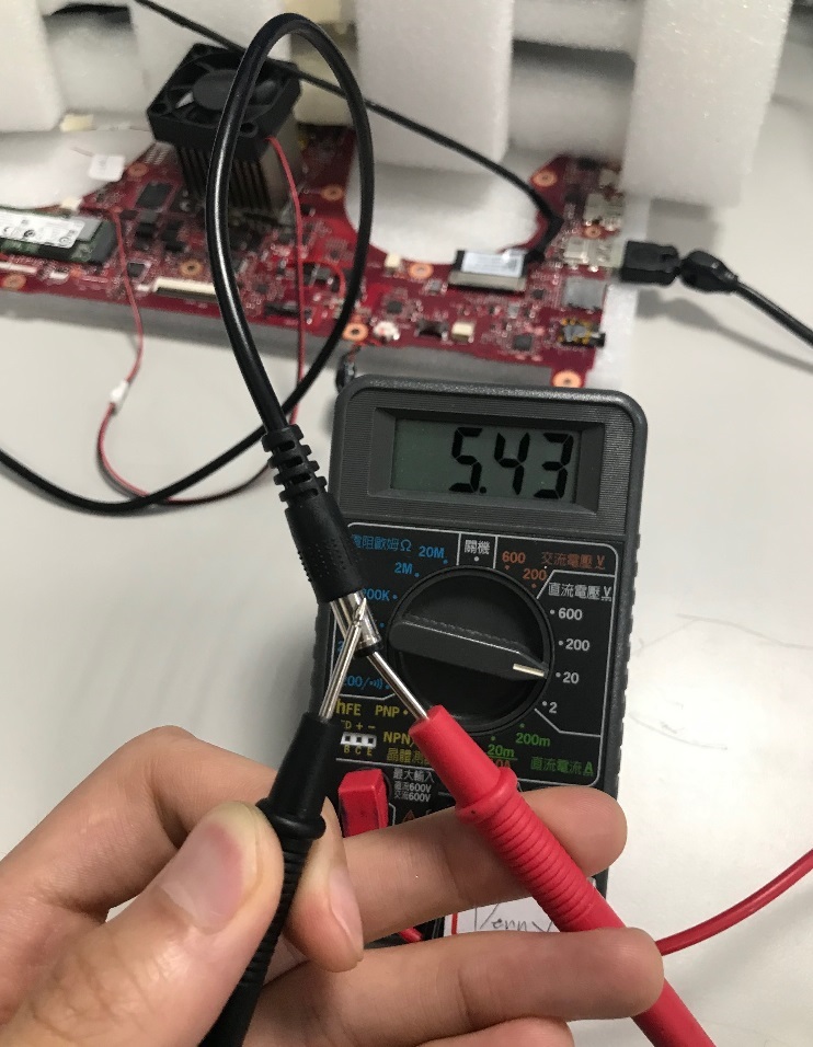

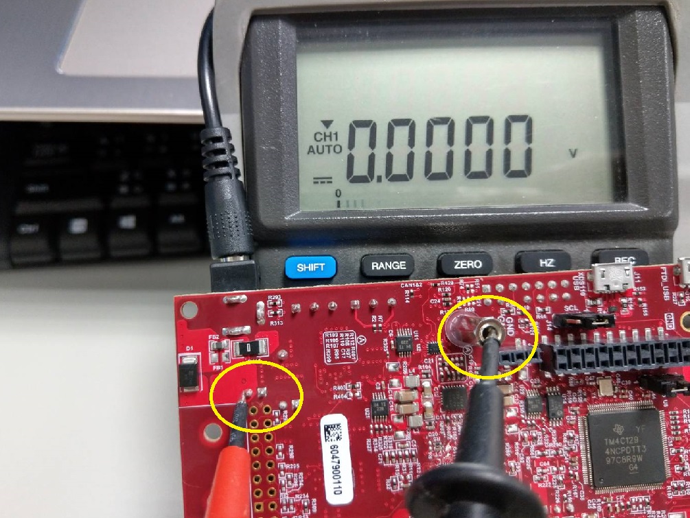

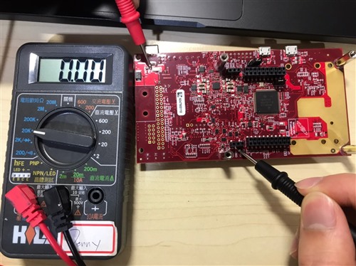

I have checked my power adapter is providing 5V, and then check the related pin after plug in the power, I do not see the 5V voltage
Does this mean which component is not ON? Can I rework a board? or need to change one new board
