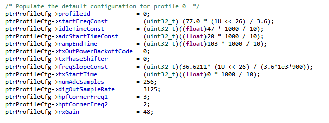

Here are my parameters(on SDK2.00.00.04)

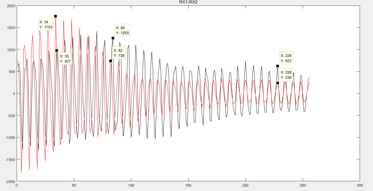

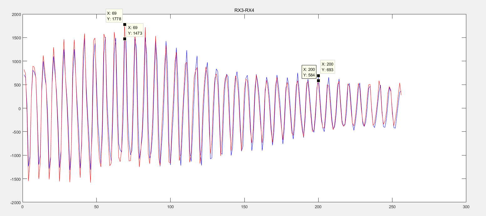

there is a problem when I try it , data from rx1 and rx2 are not aligned, were like that
but rx3 and rx4 are correct

Higher sampling rates ( 6.25M) have the same result . By the way , if start frequency = 76Ghz , the data is normal , but its wrong when start frequency = 78Ghz

Are you using complex sampling mode or real only sampling mode? In the plot above are you plotting the I data or the Q data? Incase of complex sampling the phase needs to be analyzed by using both I and Q data, not one of them.
