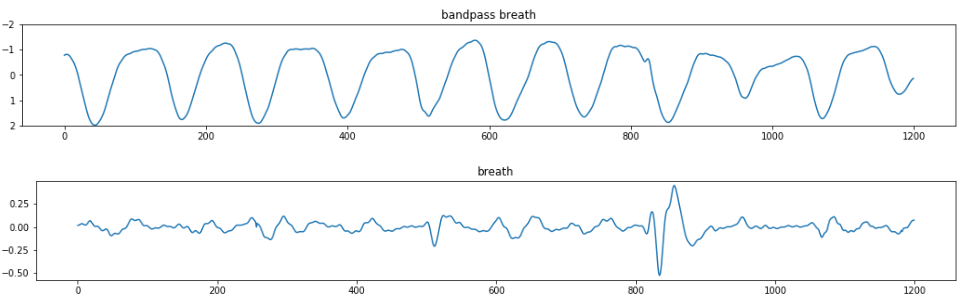

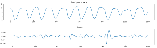

I have a question in the vital sign demo example.
The value of the range profile was extracted and separated by a bandpass filter.
There was a range bin with a better signal than the virtual signs output data.
What is the algorithm that selects the range bin to output out of 34 range bins?
The first is the data we extracted, and the second is the output data.
  • Hi Chunghee,
    This should be in the source code for the Vital Signs Lab. The algorithm might just choose a bin in the .5 meter range as per the specifications of the demo. It is also possible that the outer bin is some other source of reflection in your scene.
