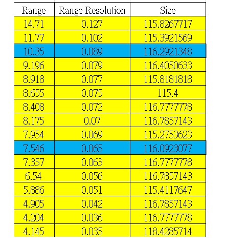

PPC application : What is the relationship of gtracking vs gtracking ?
We need to tuning other parameters for better (small) range resolution ?

Hi Agate,
If range resolution is lower, then you will expect to see less points per person. This needs to be reflected in allocation parameters. (Points Thresh and SNR Thresh)
