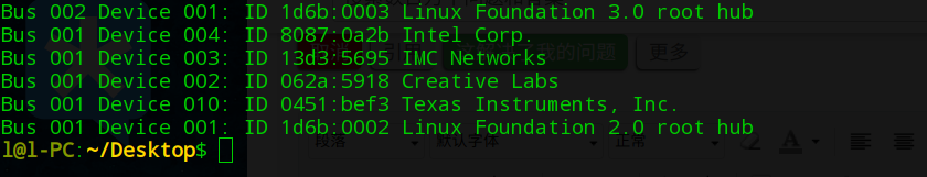

IWR1642: Run vital signs detection demo on Linux platform, but iwr1642 serial port cannot communicate with Linux device
Part Number: IWR1642
HI,
We know that iwr1642 radar provides vital signs detection demo, and in vital signs resource library, QT software is provided. We debug and run vital signs demo on Linux platform, unable to communicate with iwr1642 through serial port. Even if we try to install xds110 driver in Ti resource library, the software still prompts. data port didnt open
