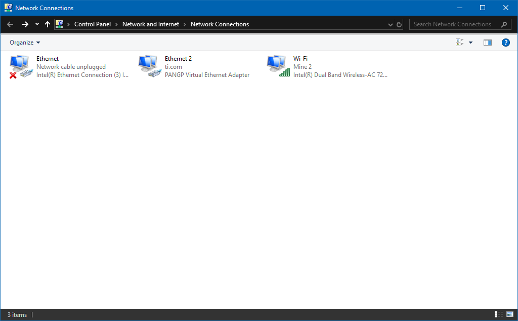

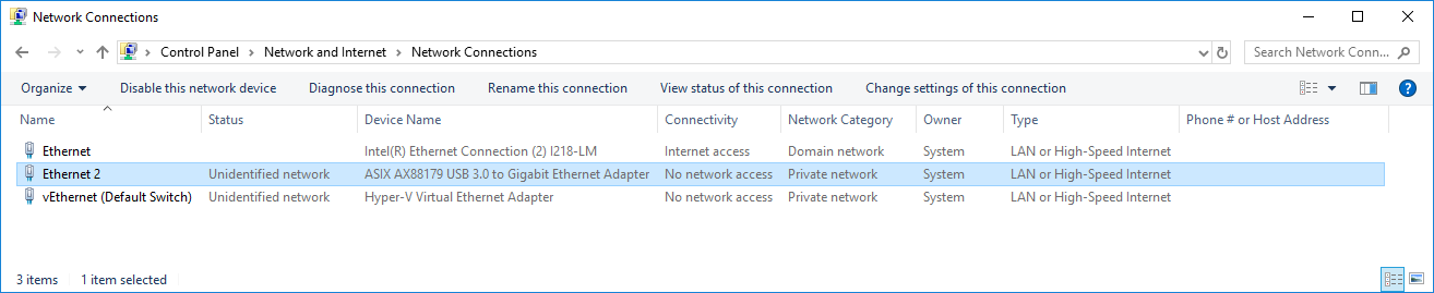

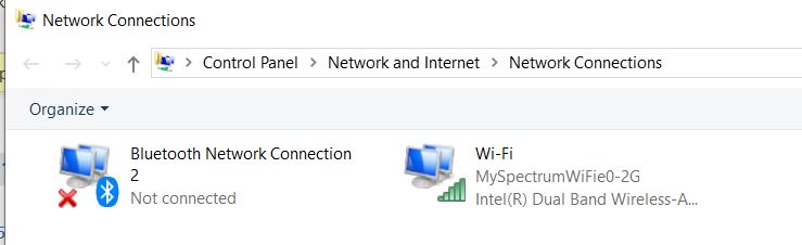

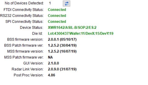

I am having a little difficulty with the DCA1000EVM. I am using it alongside the AWR1642BOOST EVM with the ultimate goal of vital detection. I would like to access the ADC data stream in MATLAB, however am having difficulty properly setting up the ADC1000 in the provided GUI first. I tried to follow the instructions outlined in the training video (https://training.ti.com/dca1000-training-video) but am having trouble with the Set Up DCA1000 feature on the left-hand side of the GUI (describe at 12:00). When I try to press ‘Connect, Reset and Configure’ I get the following error message in the output:
This occurs when I press 'connect, reset and configure' in the following (note the lack of FPGA Version #):
Additional information on my current configuration:
The device also gets extremely warm very quickly . Does the board have any heatsinks? If not, should I be running it with a fan? I am concerned that this is related to the issues I am seeing above. Any insight you can provide into these issues will be much appreciated! Hope you are doing well during these crazy times.
