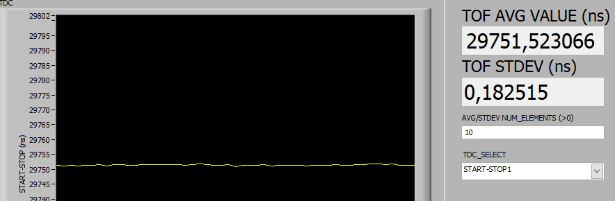

Hallo,

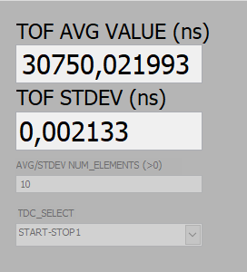

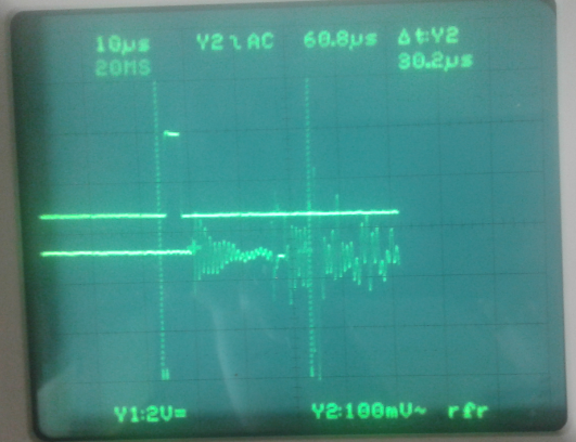

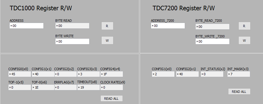

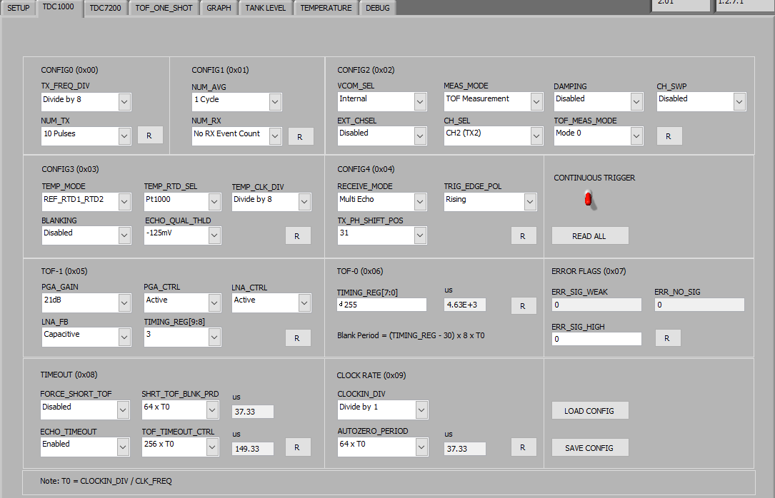

I bought the TDC1000-TDC7200EVM  a while ago. Now I finaly got time to try it out. I followed every step in the "TDC1000-TDC7200EVM User’s Guide ". I got the GUI running, but after the firmware update I got no signals from the device. I maesured and there was only a start Signal. After than resetting the TDC1000 via the GUI debug tab I finaly got Signals, but they were constant. I tried mouting the transducer on a sutible container an filling it with water, but i still got the same values. That made no sense. I tried playing with the settings, but I still dit not get anny usefull data. Reinstaling everything changed nothing.
Here are the Registersettings and the result  I get.
I realy hope you can help me out.
Tobias

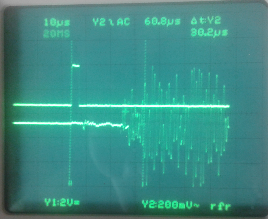

  • Tobias,
    Have you monitored the COMP_IN signal on an oscilloscope at time 30us from the START pulse? Usually a repeated value such as ~30us when using a 1MHz transducer is due to the threshold detecting the ring-decay of the transducer after burst. This ring-decay is reported as a false positive, and since it does not fluctuate, the readout value seems constant. This can be resolved in several ways:
    • Enable and increase the BLANKING and TIMING_REG value to delay echo detection to start after +30us. Depending on the minimum time of flight value you want to detect, you could set the blanking time to end just before.
    • Increase the threshold (ECHO_QUAL_THLD in CONFIG3) to be positioned above the amplitude of the ring-decay. This will prevent the ring-decay from intersecting and trigger a threshold detect.
    • On the Graph tab, instead of monitoring TDC_SELECT START-STOP1, monitor START-STOP2. The second stop pulse should be the real echo assuming the first echo is always the ring-decay created false positive. Note: you will need to enable multi-echo mode in RECEIVE MODE (CONFIG4), and set the NUM_RX to 2 STOP (CONFIG1).

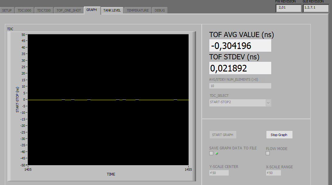

  • Hallo Mr. Whitehead,
    thank you for the fast replay. I tried all your sugestions. I am currently working at home and I olny have one oscilloscobe probe at home. I got a Signal from the COMP-IN testpoints but without a second probe I can't tell the time after the start pulse. Never the less I tried out your solutions. Sadly nothing workt. Enableling Blanking sinply added the timeintervall i specified in the TIMING_REG to the values. So if I added 30us I would get values around 60us. Increasing the ECHO_QUAL_THLD value changed nothing. At -1500mV I no loner got any signal. All the other Values were more of the same.  Using the second stop pulse got me negativ Values (is that even possble with these chips, see immage).  Enabeling blanking had no influence on this behaviour.
    I also got myself yesturday some cheep transducer from amazon (supposed to bee a ultrsonic humidifiyer). I pluged them in, and got exactly the same problems. So I think there is a problem with the Bord, not with the transducer.
    Also isn't the ringdecay the reason way i was supposed to cover the transducer in Hotglue after gluing it to container?
    Is there anything else I can try?
    thank you for your answer. Yes I have read the document on  how to mount the transducers. My Tank was made out of PP 1,5mm. I followed all the stepps mentioned. I used an Ethel-2-cyanacrylate glue whitch worked great.
    the sensor I used first was a SMD15T21R111WL wich was part of the dev-bord I baught. I also tries several HL0020-004 piezoelements from Audiowell whos resonance frequency was supposed to be 1 MHz+-1%.
    I also had an A-14P20  ultrsonic Sensor and tried to use it. The datasheet said that this one should have a resonance frequency of 40 kHz. I tried the whole frequency range by using TX-FREQ-DIV But I got nothing even when using the PGA from 3 - 18 dB. At 21 dB i wiredly enaugh got nearly the same signal  at TX-FREQ-DIV=4 as with the 1MHz transducers still konstant. That does not make any sense..
    Do I neet to conect the A-14P20 to different terminals than TX1/RX2(J5, pin 8) and GND(J5, pin 7), because of filtering issues? There was nothing about that in the Userguide.
    I will try another transducer from an HC-SR04 module wich i have used before in a hoby projekt. This one also has a 40 kHz resonance frequency. I know that this one works but I don't have high hopes.
    I still think there is something wrong with the Board
    Any other Ideas?

  • Hallo Akeem,

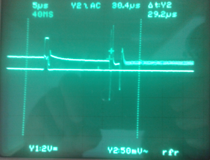

    I finaly got a second probe. I only have an old analog oszilicope but it still does the job. In the picture you see the signal, that I got from the mouted transducer. You can clearly see the ring attenuation, or what I percive to be the attenuation, in the first 10 us. But that is not the signal the bord ist trigerring on. The signal it self is very week an I tried to put the marker shortly before the trigeringpoints so that you can see the peak. With this I get about the same time measurement as in the TDC1000_7200_EVm-Software.  If I put water in the Container nothing changes not even a single diget. I played with the Gain-settings but that changed only the amplitude of the Signal. Still there was no difference with ore without water, or concentrates NaCl solution.
    When i Put the bare chinese Transducer from Audiowell in I got nearly the same signal with a higher amplitude. The TOF-Value was nearly the same. Here is a picture of the signal with the same Settings a before:
    there is no real ringdecay visible here and a far as I know, this transducer should not even work, because it is for mistmaking and requires much larger voltage. I got it for a nother project and just pluggt it in.
    From the same project I got an 1,7 Mhz transducer. And that one gives me nearly the same Signal wich should not bepossible,  because we dont use the right resonance frequency.
    I also tried using Blanking. But the signal just looked the same but was moved by the specified time and was more atenuated the bigger  that amount of time was.
    So I am still puzzeld by this behaviour, but maybe you can make sens of this.

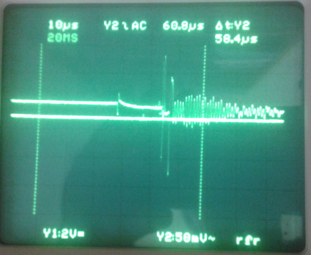

  • Tobias,
    Based on your screen capture, there appears to be a larger than usual amount of noise present at the input of the AFE. This is either coming from the transducer itself, or one of the internal rails of the receiver path is unstable.
    First, let's debug whether it is the transducer by performing a listen only measurement. You have two means of accomplishing this:
    • Using your existing connection, set the number of pulses to 0, and start a measurement. By setting pulses to 0, the transducer itself will not be forced to resonate, and will only respond to external noise (if present).
    • If you are unable to set the number of pulses to 0, but still minimize to 1 pulse, connect your transducer to Channel 2, and change your ToF mode setting such that Channel 1 (TX1/RX2) transmits, and Channel 2 (TX2/RX1) receives. This will isolate the driver from the receiver path.
      • Another experiment to perform in this configuration is to connect Channel 2 to ground. When you capture the ToF at COMP_IN, the signal should be at the input referred noise (which should be very low). If the large noise signal appears even when the receiver input is grounded, then there is either an external component or device failure.
    To see the burst and ring-decay waveforms on the scope, you need to enable FORCE_SHORT_TOF; otherwise, these signals will always appear masked/hidden as you've shown.
    It is important while performing this benchmark testing that the transducers not be mounted to the tank, and instead they be positioned, pointed, and encased by an absorbent sponge like material. For transducer debug, minimizing the number of external and mechanical variables is important.
    Be sure that you are probing the buffered output version of COMP_IN, and not the COMP_IN pin directly. The oscilloscope probe at COMP_IN can distort and amplify noise of the waveform.

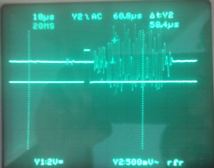

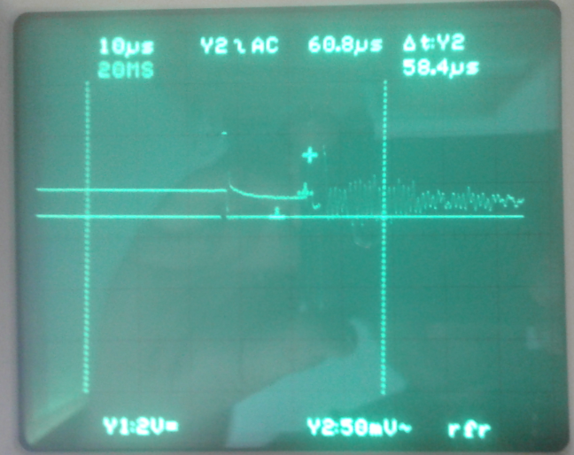

  • Hallo Mr Whitehead,
    thank you for your fast reply and being so patient with me. This is really not easy for me and I always think that there is some stupid little detail I am missing. But back to the matter at hand.
    It was quite the hustle to get the transducer off the container. It looks rather ugly now but it is not broken. I found an unused PE sponge, cut i open put the transducer in  it, and wrapped a towel around the contraption for good measure. I set the numer of pulses to 0 by sending a Hex 40 command to the CONFIG0 Register. At first I got no Signal at lest nothing that comes close to the signal I had before. Then I lowered the trigger and got the signal you see below (other V division!!). It is not much longer than you can see. Changing TRIGGER UPDATE FREQ did not influence the signal.
    By the way this signal did not change, when I removed the transducer from the sponge.
    With your second Method I was not sure how to achieve that. The datasheet doesn't even mention that possibility as far as I understand it. But I tried according to the description on page 20 and 21 in the datasheet. I set TOF_MEAS_MODE to 1, shorted the TX1 to ground and put the Transducer in RX1. Using this method I got the same Signal as above, but now it triggered together with the start signal. The signal did not change regardless with or without sponge. When I tried the same with TOF_MEAS_MODE =0  i.e. grounding TX1 and putting the Transducer in RX2 I got the same unchanged signal as I described in the last post. Are those shorted together?
    Weirdly enough, when I removed all cables in TOF_MEAS_MODE = 1 configuration, I still got two small peaks after the start signal on the COMP_In line. See Below. Is that normal? I also did this with TOF_MEAS_MODE = 0 and no transducer attached and sure enough these two peaks are still there but more attenuated.
    Now I tried to get the burst and ring decay as you described. I reset everything, put the transducer in TX1/RX2 and enabled FORCE_SHORT_TOF. Now I got the following signal. That is not what I expected. I was expecting four more or less identical peaks and then a damped sine-wave. But of course I don't have enough experience to judge that.
    I retried all the above mentioned tests with the Audiowell-transducers I mentioned before and got more or less the same results.
    I hope you can make something of this.

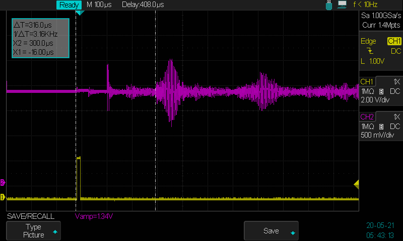

  • Hi Tobias,

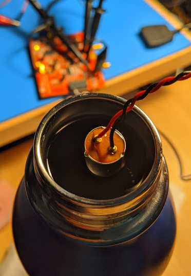

    I've captured an alternative working example at 220kHz. Here are the test conditions:
    • EVM Hardware: TDC1000-TDC7200EVM (Red Board)
    • Transducer: Massa E-188/220 (220kHz) with 3.3kOhm damping resistor in parallel to the transducer.
    • Target: 24cm water level from top of water surface; transducer face is submerged in water. Assuming speed of sound is 1500m/s in water, the round trip time of flight will be 320us.
    Here is a photo of the physical setup:

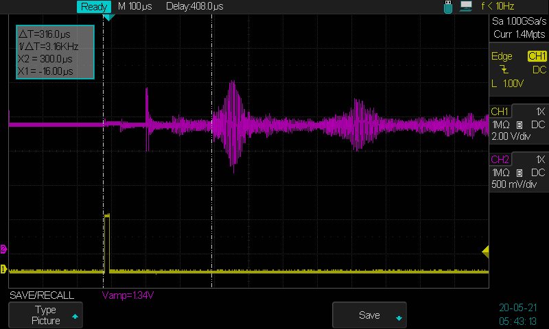

    Here are the oscilloscope results:
    • CH1 (yellow) = START pin
    • CH2 (red) = COMP_IN (buffered output)
    Notice the delta between the cursors is about 316us from the START pulse to the beginning of the first echo at COMP_IN. This is our 24cm level sensed height.

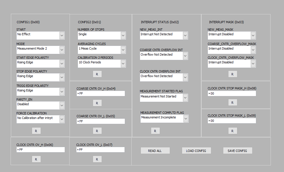

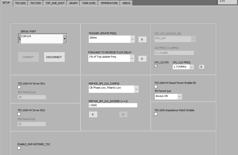

    Attached is the GUI configuration file for the TDC devices and snapshots of the GUI setup:

    Notice the CPU_CLOCK is set at 1.7143MHz. So when we apply a clock divider of 8, the resulting driver pulse is 214kHz, which is very close to the 220kHz requirement of the transducer.
    I hope this serves as a good working benchmark to test your setup. You may need to get a sample of the same transducer for an exact comparison, but the point of this exercise is to show you the typical levels of the COMP_IN output, which should not be as noisy as you have shown in your previous oscilloscope captures.
