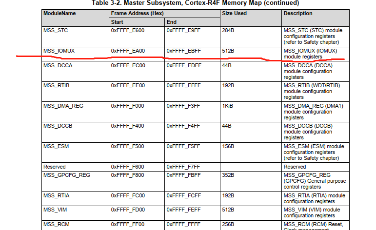

We've started designing the PCB and did not find the detailed description about MSS_IOMUX. Would you please given me a link to the detailed document?

Hi Tom,
Please refer to section 4 of datasheet @https://www.ti.com/lit/ds/symlink/iwr6843.pdf
For programming please refer to @C:\ti\mmwave_sdk_03_03_00_03\packages\ti\drivers\pinmux
