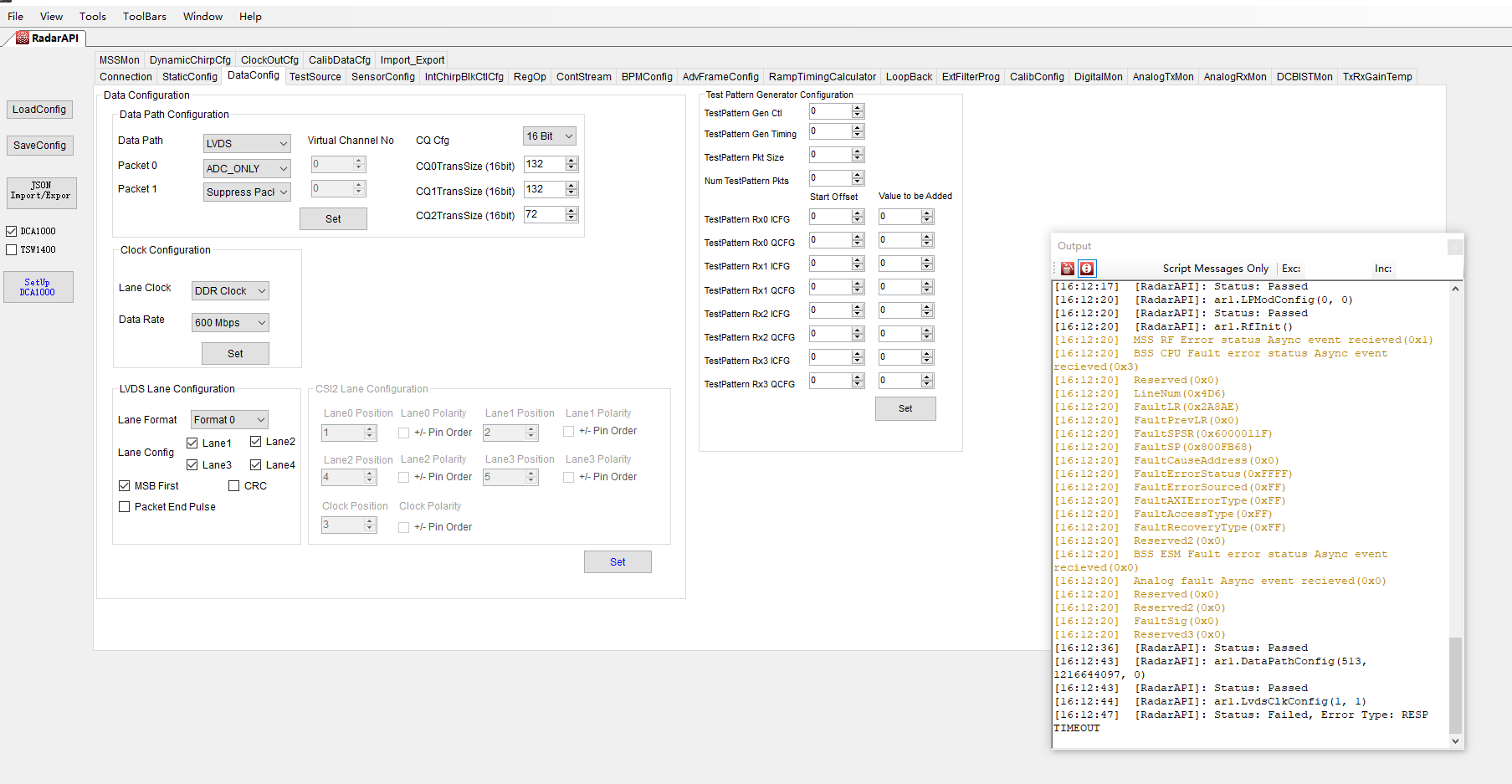

DCA1000EVM: LvdsClkConfig RESP TIMEOUT
Part Number: DCA1000EVM
Other Parts Discussed in Thread: IWR1443BOOST, , UNIFLASH, IWR1443
GM: Constructor
GM: Thu Apr 16 13:29:52 2020
RSTD.Transmit("/Settings")
[13:29:52]
[13:29:52] ### Running Startup script: "C:\ti\mmwave_studio_02_00_00_02\mmWaveStudio\Scripts\Startup.lua" ###
[13:29:52] RSTD.SetAndTransmit ("/Settings/Scripter/Display DateTime" , "1")
[13:29:52] RSTD.SetAndTransmit ("/Settings/Scripter/DateTime Format" , "HH:mm:ss")
[13:29:52] Scripter ignored: Attempt to UnBuild() again or before Build.
[13:29:52] RSTD.SetVar ("/Settings/Clients/Client 0/Dll" , "C:\\ti\\mmwave_studio_02_00_00_02\\mmWaveStudio\\Clients\\\\LabClient.dll")
[13:29:53] RSTD.SetVar ("/Settings/Clients/Client 0/Use" , "TRUE")
[13:29:53] RSTD.SetVar ("/Settings/Clients/Client 1/Use" , "FALSE")
[13:29:53] RSTD.SetVar ("/Settings/Clients/Client 2/Use" , "FALSE")
[13:29:53] RSTD.SetVar ("/Settings/Clients/Client 3/Use" , "FALSE")
[13:29:53] RSTD.SetVar ("/Settings/Clients/Client 4/Use" , "FALSE")
[13:29:53] RSTD.SetVar ("/Settings/AL Client/AL Dll" , "C:\\ti\\mmwave_studio_02_00_00_02\\mmWaveStudio\\RunTime\\SAL.dll")
[13:29:53] RSTD.SetVar ("/Settings/Clients/Client 0/GuiDll" , "")
[13:29:53] RSTD.SetVar ("/Settings/AutoUpdate/Enabled" , "TRUE")
[13:29:53] RSTD.SetVar ("/Settings/AutoUpdate/Interval" , "1")
[13:29:53] RSTD.SetVar ("/Settings/Monitors/UpdateDisplay" , "TRUE")
[13:29:53] RSTD.SetVar ("/Settings/Monitors/OneClickStart" , "TRUE")
[13:29:53] RSTD.SetVar ("/Settings/Automation/Automation Mode" , "false")
[13:29:53] RSTD.Transmit("/")
[13:29:53] RSTD.SaveSettings(): Settings saved to "C:\Users\Zhaoy\AppData\Roaming\RSTD\config.xml"
[13:29:53] RSTD.Build()
[13:29:53] RSTD.AL_Build()
[13:29:53] RSTD.AL_LoadXml()
[13:29:53] RSTD.AL_Init()
[13:29:53] RSTD.Clients_Build()
[13:29:53] GM: Init
[13:29:53] GM: Loaded 'C:\ti\mmwave_studio_02_00_00_02\mmWaveStudio\Clients\\LabClient.dll'
[13:29:53] GM: 1 Guest (s) init
[13:29:53] GM: 1 Module(s) init
[13:29:53] GM: 2 Tab (s) init
[13:29:53] RSTD.Client_LoadXml()
[13:29:53] [RadarAPI]: Starting Matlab Engine..
[13:29:57] [RadarAPI]: Matlab Engine Started!
[13:30:00] [RadarAPI]: ar1.LoadSettings('C:\Users\Zhaoy\AppData\Roaming\RSTD\ar1gui.ini')
[13:30:00] TESTING = false
[13:30:00]
[13:30:00] ***Script completed successfully.***
[13:30:14] [RadarAPI]: Opening Gpio Control Port()
[13:30:14] [RadarAPI]: Status: Passed
[13:30:15] [RadarAPI]: Opening Board Control Port()
[13:30:15] [RadarAPI]: Status: Passed
[13:30:16] [RadarAPI]: ar1.FullReset()
[13:30:16] [RadarAPI]: Status: Passed
[13:30:16] [RadarAPI]: Closing Board Control Port()
[13:30:16] [RadarAPI]: Closing Gpio Control Port()
[13:30:16] [RadarAPI]: ar1.SOPControl(2)
[13:30:18] [RadarAPI]: ar1.Connect(3,115200,1000)
[13:30:19] [RadarAPI]: ar1.Calling_IsConnected()
[13:30:20] [RadarAPI]: ar1.SelectChipVersion("AR1243")
[13:30:20] [RadarAPI]: Status: Passed
[13:30:20] [RadarAPI]: RS232 is not connected ..!!!!
[13:30:20] [RadarAPI]: ar1.frequencyBandSelection("77G")
[13:30:20] [RadarAPI]: ar1.SelectChipVersion("XWR1443")
[13:30:20] Device Status : XWR1443/QM/SOP:2/ES:3
[13:30:21] [RadarAPI]: ar1.SelectChipVersion("AR1243")
[13:30:21] [RadarAPI]: Status: Passed
[13:30:21] [RadarAPI]: ar1.SelectChipVersion("XWR1443")
[13:30:21] Device Status : XWR1443/QM/SOP:2/ES:3
[13:30:21] [RadarAPI]: ar1.SaveSettings('C:\Users\Zhaoy\AppData\Roaming\RSTD\ar1gui.ini')
[13:30:22] [RadarAPI]: ar1.DownloadBSSFw("C:\\ti\\mmwave_studio_02_00_00_02\\rf_eval_firmware\\radarss\\xwr12xx_xwr14xx_radarss.bin")
[13:30:23] [RadarAPI]: Downloading BSS Patch RPRC Binary..
[13:30:30] [RadarAPI]: ar1.GetBSSFwVersion()
[13:30:30] [RadarAPI]: BSSFwVersion:(02.00.00.01 (05/10/17))
[13:30:31] [RadarAPI]: ar1.GetBSSPatchFwVersion()
[13:30:31] [RadarAPI]: BSSPatchFwVersion:(01.02.00.03 (24/10/18))
[13:32:31] [RadarAPI]: ar1.DownloadMSSFw("C:\\ti\\mmwave_studio_02_00_00_02\\rf_eval_firmware\\masterss\\xwr12xx_xwr14xx_masterss.bin")
[13:32:31] [RadarAPI]: Downloading MSS RPRC Binary..
[13:32:51] [RadarAPI]: ar1.PowerOn(0, 1000, 0, 0)
[13:32:51] [RadarAPI]: Status: Passed
[13:32:51] MSS power up done async event received!
[13:32:59] [RadarAPI]: ar1.RfEnable()
[13:32:59] BSS power up done async event received!
[13:32:59] [RadarAPI]: Status: Passed
[13:33:00] [RadarAPI]: ar1.GetBSSFwVersion()
[13:33:00] [RadarAPI]: BSSFwVersion:(02.00.00.01 (05/10/17))
[13:33:01] [RadarAPI]: ar1.GetBSSPatchFwVersion()
[13:33:01] [RadarAPI]: BSSPatchFwVersion:(01.02.00.03 (24/10/18))

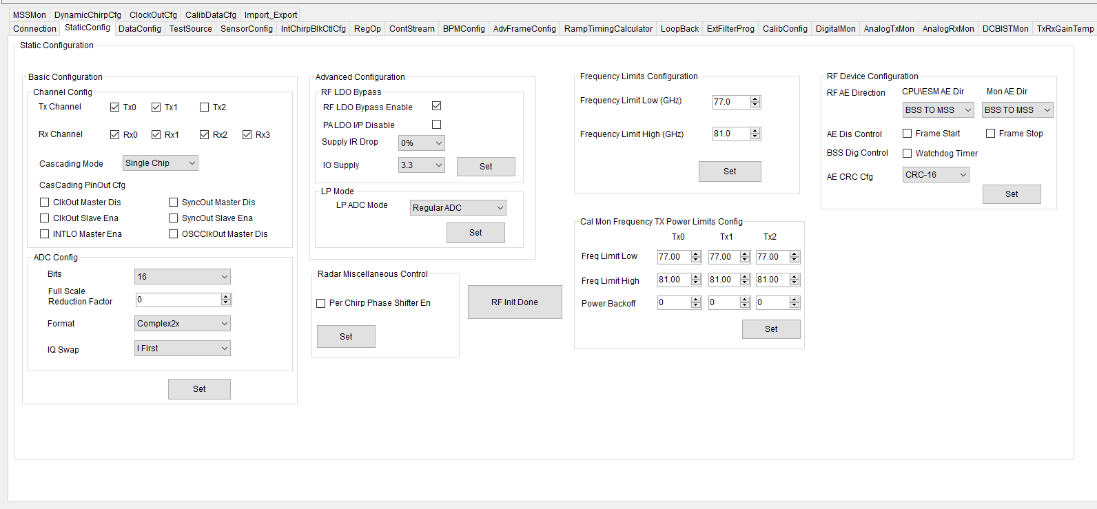

[13:33:15] [RadarAPI]: ar1.ChanNAdcConfig(1, 1, 0, 1, 1, 1, 1, 2, 2, 0)
[13:33:15] [RadarAPI]: Status: Passed
[13:33:25] [RadarAPI]: ar1.LPModConfig(0, 0)
[13:33:25] [RadarAPI]: Status: Passed
[13:33:28] [RadarAPI]: ar1.RfInit()
[13:33:28] MSS RF Error status Async event recieved(0x1)
[13:33:28] BSS CPU Fault error status Async event recieved(0x3)
[13:33:28] Reserved(0x0)
[13:33:28] LineNum(0x4D6)
[13:33:28] FaultLR(0x2A8AE)
[13:33:28] FaultPrevLR(0x0)
[13:33:28] FaultSPSR(0x6000011F)
[13:33:28] FaultSP(0x800FB68)
[13:33:28] FaultCauseAddress(0x0)
[13:33:28] FaultErrorStatus(0xFFFF)
[13:33:28] FaultErrorSourced(0xFF)
[13:33:28] FaultAXIErrorType(0xFF)
[13:33:28] FaultAccessType(0xFF)
[13:33:28] FaultRecoveryType(0xFF)
[13:33:28] Reserved2(0x0)
[13:33:28] BSS ESM Fault error status Async event recieved(0x0)
[13:33:28] Analog fault Async event recieved(0x0)
[13:33:28] FaultSig(0x0)
[13:33:28] Reserved3(0x0)
[13:33:31] [RadarAPI]: Status: Passed

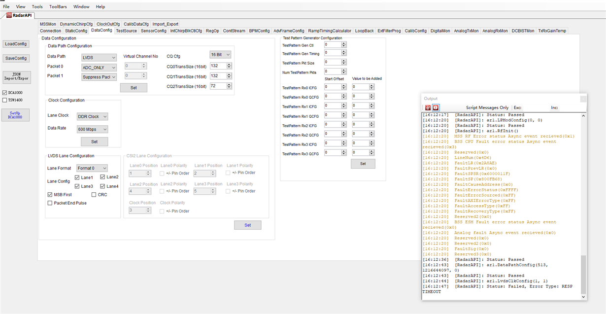

[13:33:34] [RadarAPI]: ar1.DataPathConfig(513, 1216644097, 0)
[13:33:34] [RadarAPI]: Status: Passed
[13:33:38] [RadarAPI]: ar1.LvdsClkConfig(1, 1)
[13:33:42] [RadarAPI]: Status: Failed, Error Type: RESP TIMEOUT
[13:33:45] [RadarAPI]: ar1.LVDSLaneConfig(0, 1, 1, 1, 1, 1, 0, 0)
[13:33:48] Status: Failed, Error Type: RESP TIMEOUT

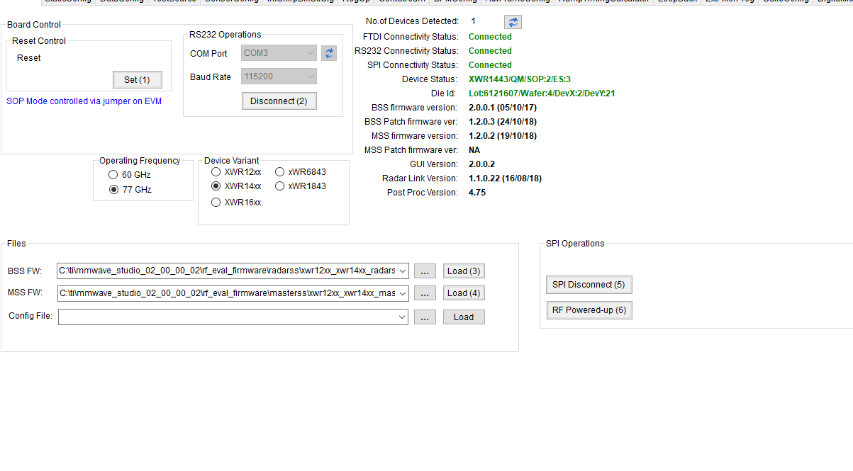

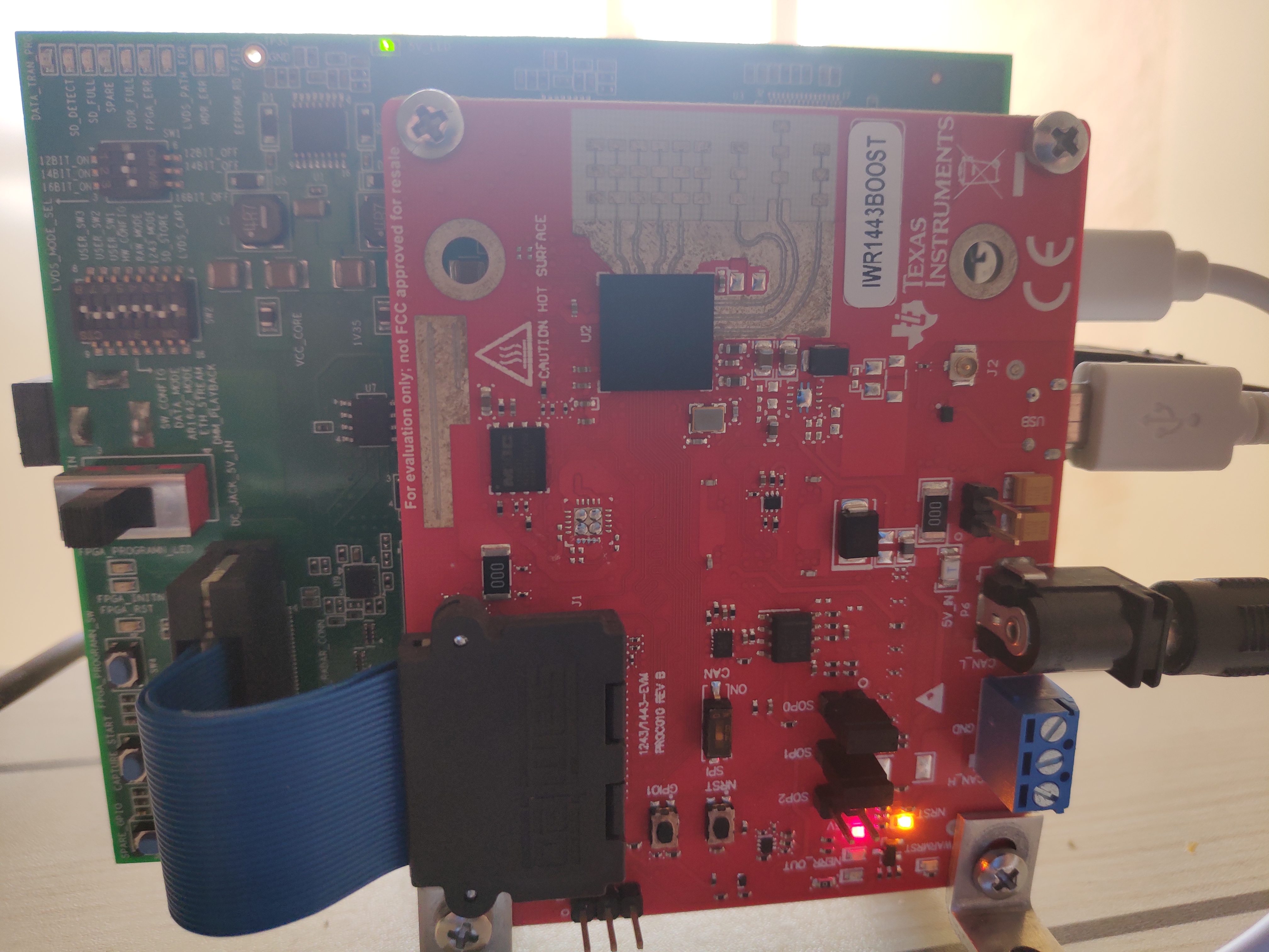

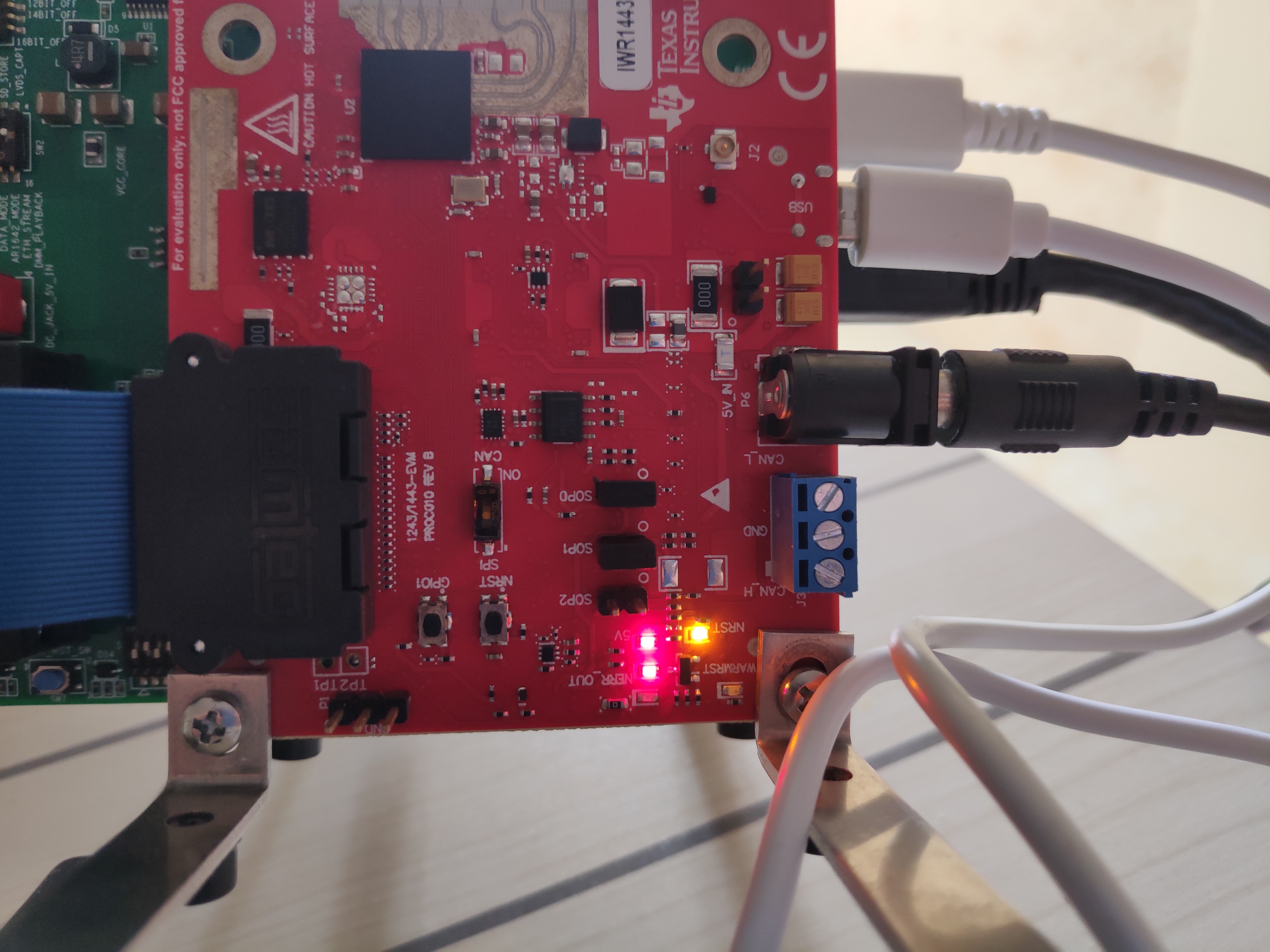

    I can see there is BSS CPU Fault error in the output log. Did you make sure that sFlash is erased before this experiment and device is set to SOP-2 mode (jumpers on : SOP-0 and SOP-2).
    And what about if you try to run mmw demo application on the same board from SDK?
    Jitendra

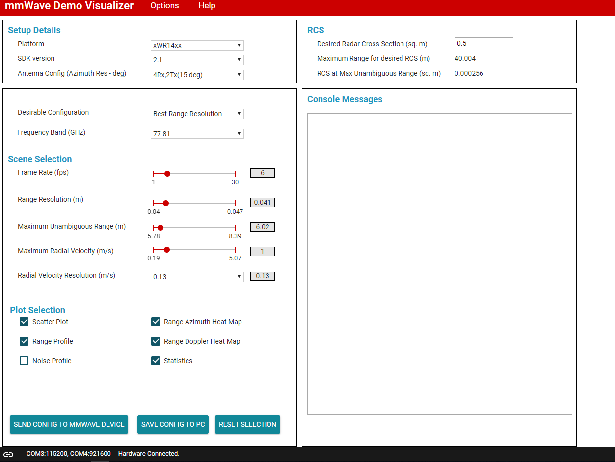

  • Before the data can be collected normally, there is an error today
    I'm sure sFlash is erased
    Click the send config to mmwave device, no response
    In demo mode, sop0 = 1,sop1,2=0;
    In the case of data collection,This is my configuration
    thank you!

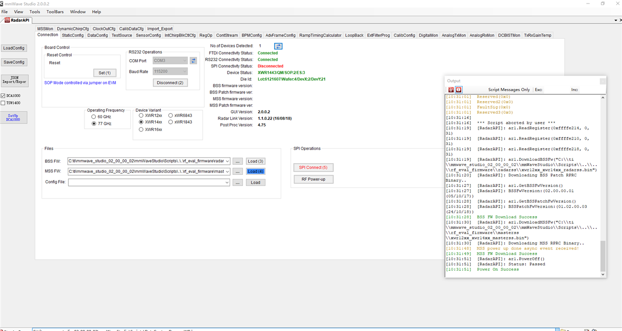

  • GM: Constructor
    GM: Sat Apr 18 10:27:10 2020
    [10:27:10]
    [10:27:10] ### Running Startup script: "C:\ti\mmwave_studio_02_00_00_02\mmWaveStudio\Scripts\Startup.lua" ###
    [10:27:10] RSTD.SetAndTransmit ("/Settings/Scripter/Display DateTime" , "1")
    [10:27:10] RSTD.SetAndTransmit ("/Settings/Scripter/DateTime Format" , "HH:mm:ss")
    [10:27:10] Scripter ignored: Attempt to UnBuild() again or before Build.
    [10:27:10] RSTD.SetVar ("/Settings/Clients/Client 0/Dll" , "C:\\ti\\mmwave_studio_02_00_00_02\\mmWaveStudio\\Clients\\\\LabClient.dll")
    [10:27:10] RSTD.SetVar ("/Settings/Clients/Client 0/Use" , "TRUE")
    [10:27:10] RSTD.SetVar ("/Settings/Clients/Client 1/Use" , "FALSE")
    [10:27:10] RSTD.SetVar ("/Settings/Clients/Client 2/Use" , "FALSE")
    [10:27:10] RSTD.SetVar ("/Settings/Clients/Client 3/Use" , "FALSE")
    [10:27:10] RSTD.SetVar ("/Settings/Clients/Client 4/Use" , "FALSE")
    [10:27:10] RSTD.SetVar ("/Settings/AL Client/AL Dll" , "C:\\ti\\mmwave_studio_02_00_00_02\\mmWaveStudio\\RunTime\\SAL.dll")
    [10:27:10] RSTD.SetVar ("/Settings/Clients/Client 0/GuiDll" , "")
    [10:27:10] RSTD.SetVar ("/Settings/AutoUpdate/Enabled" , "TRUE")
    [10:27:10] RSTD.SetVar ("/Settings/AutoUpdate/Interval" , "1")
    [10:27:10] RSTD.SetVar ("/Settings/Monitors/UpdateDisplay" , "TRUE")
    [10:27:10] RSTD.SetVar ("/Settings/Monitors/OneClickStart" , "TRUE")
    [10:27:10] RSTD.SetVar ("/Settings/Automation/Automation Mode" , "false")
    [10:27:10] RSTD.Transmit("/")
    [10:27:10] RSTD.SaveSettings(): Settings saved to "C:\Users\Zhaoy\AppData\Roaming\RSTD\config.xml"
    [10:27:10] RSTD.Build()
    [10:27:10] RSTD.AL_Build()
    [10:27:10] RSTD.AL_LoadXml()
    [10:27:10] RSTD.AL_Init()
    [10:27:10] RSTD.Clients_Build()
    [10:27:10] GM: Init
    [10:27:10] GM: Loaded 'C:\ti\mmwave_studio_02_00_00_02\mmWaveStudio\Clients\\LabClient.dll'
    [10:27:10] GM: 1 Guest (s) init
    [10:27:10] GM: 1 Module(s) init
    [10:27:10] GM: 2 Tab (s) init
    [10:27:10] RSTD.Client_LoadXml()
    [10:27:10] [RadarAPI]: Starting Matlab Engine..
    [10:27:14] [RadarAPI]: Matlab Engine Started!
    [10:27:19] [RadarAPI]: ar1.LoadSettings('C:\Users\Zhaoy\AppData\Roaming\RSTD\ar1gui.ini')
    [10:27:19] TESTING = false
    [10:27:19]
    [10:27:19] ***Script completed successfully.***
    [10:27:23] [RadarAPI]: Opening Gpio Control Port()
    [10:27:23] [RadarAPI]: Status: Passed
    [10:27:24] [RadarAPI]: Opening Board Control Port()
    [10:27:24] [RadarAPI]: Status: Passed
    [10:27:25] [RadarAPI]: ar1.FullReset()
    [10:27:25] [RadarAPI]: Status: Passed
    [10:27:26] [RadarAPI]: Closing Board Control Port()
    [10:27:26] [RadarAPI]: Status: Passed
    [10:27:26] [RadarAPI]: Closing Gpio Control Port()
    [10:27:26] [RadarAPI]: ar1.SOPControl(2)
    [10:27:27] [RadarAPI]: ar1.Connect(3,115200,1000)
    [10:27:28] [RadarAPI]: ar1.Calling_IsConnected()
    [10:27:29] [RadarAPI]: ar1.SelectChipVersion("AR1243")
    [10:27:29] [RadarAPI]: Status: Passed
    [10:27:29] [RadarAPI]: RS232 is not connected ..!!!!
    [10:27:29] [RadarAPI]: ar1.frequencyBandSelection("77G")
    [10:27:29] [RadarAPI]: ar1.SelectChipVersion("XWR1443")
    [10:27:29] Device Status : XWR1443/QM/SOP:2/ES:3
    [10:27:30] [RadarAPI]: ar1.SelectChipVersion("AR1243")
    [10:27:30] [RadarAPI]: Status: Passed
    [10:27:30] [RadarAPI]: ar1.SelectChipVersion("XWR1443")
    [10:27:30] Device Status : XWR1443/QM/SOP:2/ES:3
    [10:27:30] [RadarAPI]: ar1.SaveSettings('C:\Users\Zhaoy\AppData\Roaming\RSTD\ar1gui.ini')
    [10:27:33] [RadarAPI]: ar1.ReadRegister(0xffffe214, 0, 31)
    [10:27:33] [RadarAPI]: ar1.ReadRegister(0xffffe210, 0, 31)
    [10:27:33] [RadarAPI]: ar1.ReadRegister(0xffffe218, 0, 31)
    [10:27:33] [RadarAPI]: ar1.DownloadBSSFw("C:\\ti\\mmwave_studio_02_00_00_02\\mmWaveStudio\\Scripts\\..\\..\\rf_eval_firmware\\radarss\\xwr12xx_xwr14xx_radarss.bin")
    [10:27:33] [RadarAPI]: Downloading BSS Patch RPRC Binary..

    [10:28:10] [RadarAPI]: ar1.ChanNAdcConfig(1, 1, 0, 1, 1, 1, 1, 2, 1, 0)
    [10:28:10] [RadarAPI]: Status: Passed
    [10:28:10] ChanNAdcConfig Success
    [10:28:11] [RadarAPI]: ar1.LPModConfig(0, 0)
    [10:28:11] [RadarAPI]: Status: Passed
    [10:28:11] Regualar mode Cfg Success

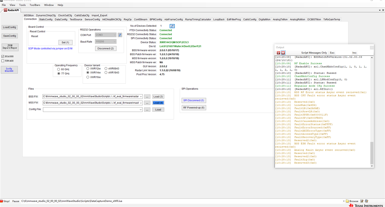

    [10:28:13] [RadarAPI]: ar1.RfInit()
    [10:28:13] MSS RF Error status Async event recieved(0x1)
    [10:28:13] BSS CPU Fault error status Async event recieved(0x3)
    [10:28:13] Reserved(0x0)
    [10:28:13] LineNum(0x4D6)
    [10:28:13] FaultLR(0x2A8AE)
    [10:28:13] FaultPrevLR(0x0)
    [10:28:13] FaultSPSR(0x6000011F)
    [10:28:13] FaultSP(0x800FB68)
    [10:28:13] FaultCauseAddress(0x0)
    [10:28:13] FaultErrorStatus(0xFFFF)
    [10:28:13] FaultErrorSourced(0xFF)
    [10:28:13] FaultAXIErrorType(0xFF)
    [10:28:13] FaultAccessType(0xFF)
    [10:28:13] FaultRecoveryType(0xFF)
    [10:28:13] Reserved2(0x0)
    [10:28:13] BSS ESM Fault error status Async event recieved(0x0)
    [10:28:13] Analog fault Async event recieved(0x0)
    [10:28:13] FaultSig(0x0)
    [10:28:13] Reserved3(0x0)
    The above is the information displayed for the first time running DEMO
    Later, I ran DEMO again, the above information was displayed, and the red light of the circuit board was on
  • And MMWAVE STUDIO appears an automatic exit
  • When using the IWR1443BOOST and DCA1000EVM together to capture raw data using mmWave Studio, the IWR1443BOOST should have jumpers on both SOP0 and SOP1.
    You also need to provide a separate power supply to the DCA1000EVM. So there will be two power supplies in your configuration, one for the IWR1443BOOST EVM and another for the DCA1000EVM. It looks like you only have a single power supply connected to the IWR1443BOOST EVM. Please add an additional power supply and connect it to the DCA1000EVM.
    Additionally, when running the Out-of-Box Demo, only SOP0 should have a jumper across. Before this step though, you flash the Out-of-Box Demo to the IWR1443BOOST EVM using Uniflash. When flashing, both SOP0 and SOP2 have jumpers across. After successfully flashing the binary, power cycle the device and then remove the SOP jumper across SOP2.

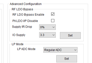

  • When I selected RF LDO BYpass Enable, I can use IWR1443 to provide power for DCA1000EVM
    Before I could use it normally to collect data, but suddenly there was an error
    Please tell me ,where is the Out-of-Box Demo Flash memory files
  • LDO Bypass Enable does not provide power for the DCA1000EVM. The LDO Bypass Enable is for providing a 1 V supply for the RF VCOs, not powering the DCA1000EVM. The DCA1000EVM requires a 5V input which is not passed through in the BoosterPack pins on your IWR1443BOOST.
    You need to add a second power supply with a rating of 5V and at least 2.5A.
    You will connect the second power supply to the DCA1000EVM and set the power switch to the "DC_JACK_5V_IN" position.
    Please take these steps listed in this response to avoid additional posts on this thread. This solution should resolve your issue.
    Kyle

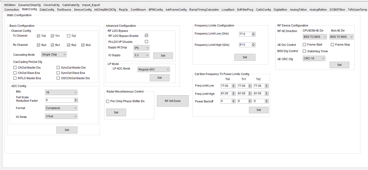

  • [10:42:13] Status: Failed, Error Type: RESP TIMEOUT
    [10:42:18] BSS Power Up async event was not received!

  • Please make sure to set the "CAN/SPI" switch on the IWR1443BOOST EVM to the SPI position. Otherwise this will cause issues when trying to use the IWR1443BOOST with the DCA1000 in mmWave Studio.
    Kyle
