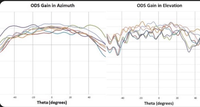

My team is designing a new antenna circuit board based on IWR6843. But the TX,RX signal power seem to be weak, so we can't set SNR threshold up to 200~300 but have to set to 5~10 for tracking and has many ghost. So we are re-designing another model for larger TX, RX antenna signal. Here're my teammates questions:
1. Is there any equipment for IWR6843 antenna testing? Any testing board for reference?
2. Each channel of Tx / Rx Gain  whether is related to DSP code?
3. Is there any correlation between antenna polarization direction and DSP code?
