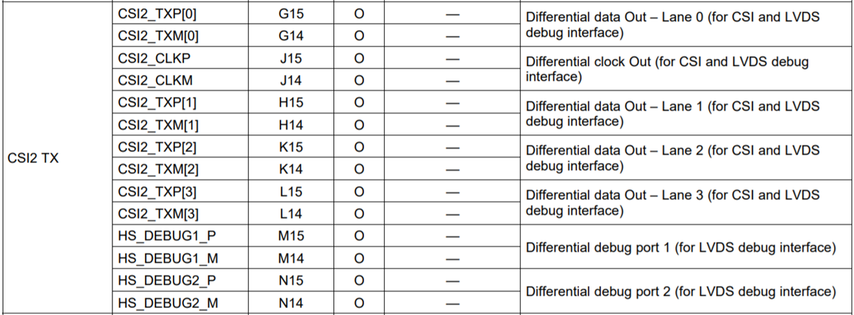

I'd like to only connect 2-Lane LVDS Interface for AWR2243 Raw ADC Data. Please confirm I should use the lower data Lane 1 and Lane 2.
AWR2243 4-Lane LVDS specification:
Lauri
  • Hello Lauri,
    yes you can use 2 CSI lanes. CSI lane config  API "AWR_DEV_CSI2_CFG_SET_SB" allows you to configure this, you can put the appropriate value in the "Lane_pos" field. A value of 0 disables that particular lane.
