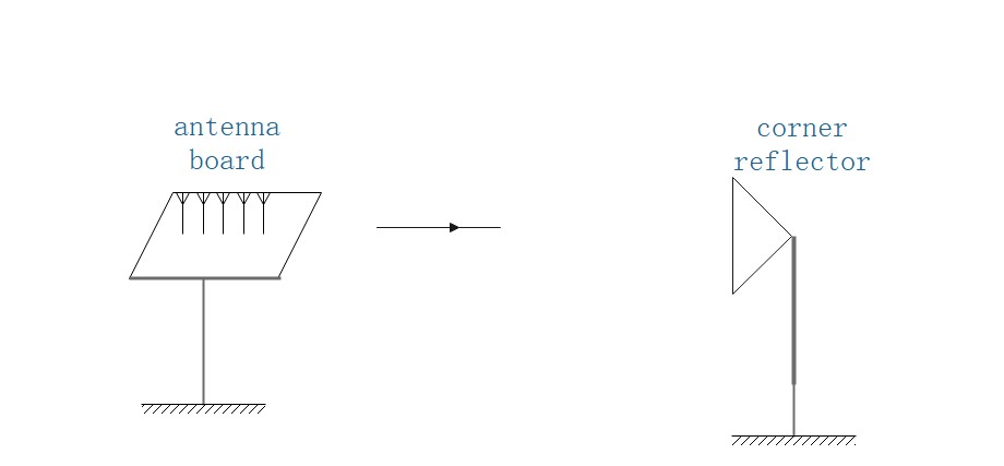

Place a corner reflector in front of the radar antenna board,When the antenna board shakes randomly,
Some target points detected have speed,and the speed value is relatively large,but there is no moving targets,
How to eliminate the speed of static target point ?

    Schematic diagram of experimental device as follow,
    The antenna board consists of three transmit antennas to form a uniform linear array and four receive antennas to form a uniform linear array.
    When the wind blows or random shaking the antenna board,but the corner reflecttor is stationary,
    For the detected target points, the speed of some target points is 0, and the speed of some target points is greater than 0,
    all the target points’  speed is 0 as expected.

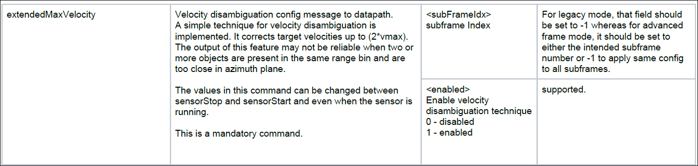

    As noted below, any motion of the target or board will result in detection of moving targets. This is not related to the Velocity extension algorithm, which is meant to correct for the aliasing (rollover) of velocity if the target is moving faster than the maximum velocity supported by the particular chirp configuration. You can indeed disable velocity extension by disabling it in the configuration file as shown in the SDK user guide (snapshot below).
    One way to reduce the effect of random motion, would be to reduce the velocity resolution in your chirp configuration. You can use the mmw demo and use the slider controls provided in the mmWave Demo Visualizer to reduce (i.e. make it coarser, so a larger physical value means lower velocity resolution) the velocity resolution and see if the effects of jitter are reduced.
