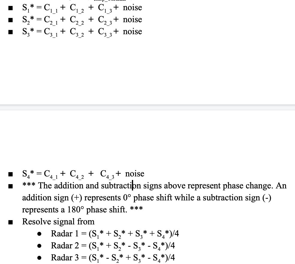

From the combined signal, how are the transmitted BPM signals disambiguated from each other at the AWR receivers?
I ask this because only one signal (the non-phase shifted signal) is fed into the AWR's mixers rather than the phase shifted signal. The end goal is to implement a BPM MIMO network where I have two AWR's in a network - one is transmitting at 0 degrees phase shift and the other (spatially located apart from eachother to increase perspective) transmitting at 180deg phase shift. In this multistatic mode, I want to be able to fuse the data from each radars perspective, but need cannot seem to disambiguate the combinded 0 and 180 deg received signals.

    Please correct me if I am wrong, but your BPM implementation is using the two transmitters on one AWR1642. I used the documentation to derive the math on how to resolve two signals, but I cannot figure out how to code the below distributed BPM MIMO implementation. That is the help I am looking for.
    I am looking for some advice on a distributed BPM MIMO implementation on the AWR. Right now, I have a distributed network of AWRs (3 of them).
    • Frame 1: Radar 1 transmits, all 3 collect
    • Frame 2: Radar 2 transmits, all 3 collect
    • Frame 3: Radar 3 transmits, all 3 collect
    • Frame 4: Radar 1 transmits, all 3 collect
    • And so on...
    But, I am trying to implement a distributed BPM MIMO implementation that looks like this:
    • Frame 1, Chirp 1-Chirp 4:
      • Block = [chirp1 chirp2 chirp3 chirp4]
        • Radar 1 transmits [0° 0° 0° 0°] = [C1_1 C2_1 C3_1 C4_1]
        • Radar 2 transmits [0° 0° 180° 180°] = [C1_2 C2_2 C3_2 C4_2]
        • Radar 3 transmits [0° 180° 0° 180°] = [C1_3 C2_3 C3_3 C4_3]
    ** Repeat this "Block" 16 times for 1 Frame, and do it 480 times so that we get all the data we need.
    ** I have done the math to resolve the signals here:
    This implementation can be seen in the attached CLI Scripts I tried to code, but the scripts for radar 2 and 3 do not run all the way through. They are also the only ones with two ProfileCfg in their scripts (one for 0 degree signal, one for 180 degree shifted signal). Radar 1 runs all the way through and transmits/collects all data. I think because it has only one ProfileCfg.  Please see this link for my other question:

    So, now that you understand the issue some more, can you help me see what the issue is with the CLI scripts as for why Radar 2 and Radar 3 do not want to transmit completely? Or, even if you have another way to implement the tactic I described above where I will be making the current successful implementation of a distributed radar network into a distributed MIMO (BPM) radar network would be absolutely great!
    Thank you so much!
    George
