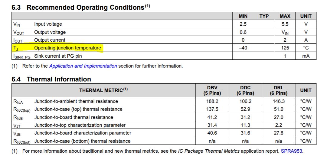

Can you provide HDC2010 junction temperature or case temperature data? My customer did not find the info inside the datasheet. Thanks.

Please direct them to page 4 of the datasheet - section 6.4 http://www.ti.com/lit/ds/symlink/hdc2010.pdf
Dear Andy -
The self heating of this device is so minimal that the max functional temperature is more or less the same as what the Tj operating max. is.
Practically, though - is there a reason you are asking about that? This is an %RH sensor too - so I am curious how you might be / are thinking about using the part at a high temperature.
