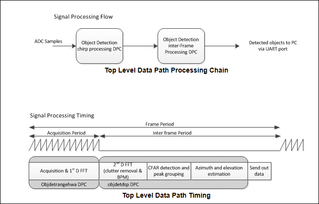

IWR6843ISK-ODS: Will the whole pipeline block if UART is not transmitting the processed data fast enough.
Part Number: IWR6843ISK-ODS
In the stock point clod demo, will the whole pipeline be blocked if the  UART does not outputting the processed data fast enough ?
i.e. if we output more debug info like the rangeAzimuthHeatMap and logMagRange, the the UART is not fast enough to output those data.
Will the TX chirp wait for the uart to be finished before TX again ?
Does the chirp do ping-pong ? i.e. another chirp is sending while the previous chirp  is still processing ?
How the firmware handle this edge case ?

  • Hi Keith,
    By design (software), the UART processing has to be completed within the current frame. This is shown in the top level datapath timing diagram in the demo html documentation (C:\ti\mmwave_sdk_03_03_00_03\docs\mmwave_sdk_module_documentation.html).
    If UART TX spills over into the next frame (i.e. the next Frame interrupt is received before UART TX completion), the DPC will generate the following exception in file objectrangehwa.c causing the demo to abort.
        /* Check if previous frame (sub-frame) processing has completed */
        DPC_Objdet_Assert(objDetObj->dpmHandle, (objDetObj->interSubFrameProcToken == 0));
        objDetObj->interSubFrameProcToken++;
    For this reason, you need to select a lower frame rate when sending heatmap data as mentioned in the SDK user guide:
