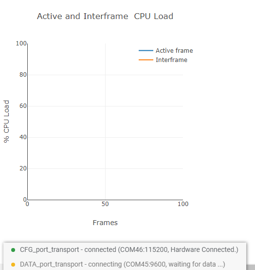

  • Hi Desmond ,

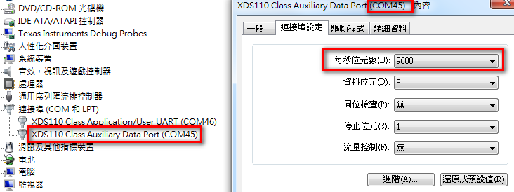

     Thank for your reply , I tried your suggest steps and check the COM port setting use the Device Manager in Windows .
     - COM46 is CFGPort with 115200 baud rate
      -COM45 is DataPort with 9600 baud rate. (It's not  recommend 921600 , and there is no 921600 option)
      so I tried running the Demo to connect  data port(COM45) with 9600 , the issue still present.
      then also adjust to 115200  in the Device Manager , and running the Demo data port with 115200, the issue still present.
      If you have any idea , please also give us the recommand baudrate setting in Device Manager when your next suggestion way , thanks.
  • Dear Wenyu:
    By default if you go into the COM port properties and check the baud rate it will be at 9600. All the that the Device Manager is needed for is so that you know which port is for configuration and which one is for data e.g. COM46 and COM 45. What is important is on the visualizer COM port setup. The CFG_port_transport and DATA_port_transport should show in the visualizer as 115200 and 921600. Once you get there check to see if any points are being displayed. If not then we can try some other things, but use the Point Cloud Demo for the 68xx ODS and follow instructions thoroughly. Also check to see if you have the SOP2 is in functional mode, and you cycle power after changing SOP2. Let me know how it goes.
    Connor Desmond

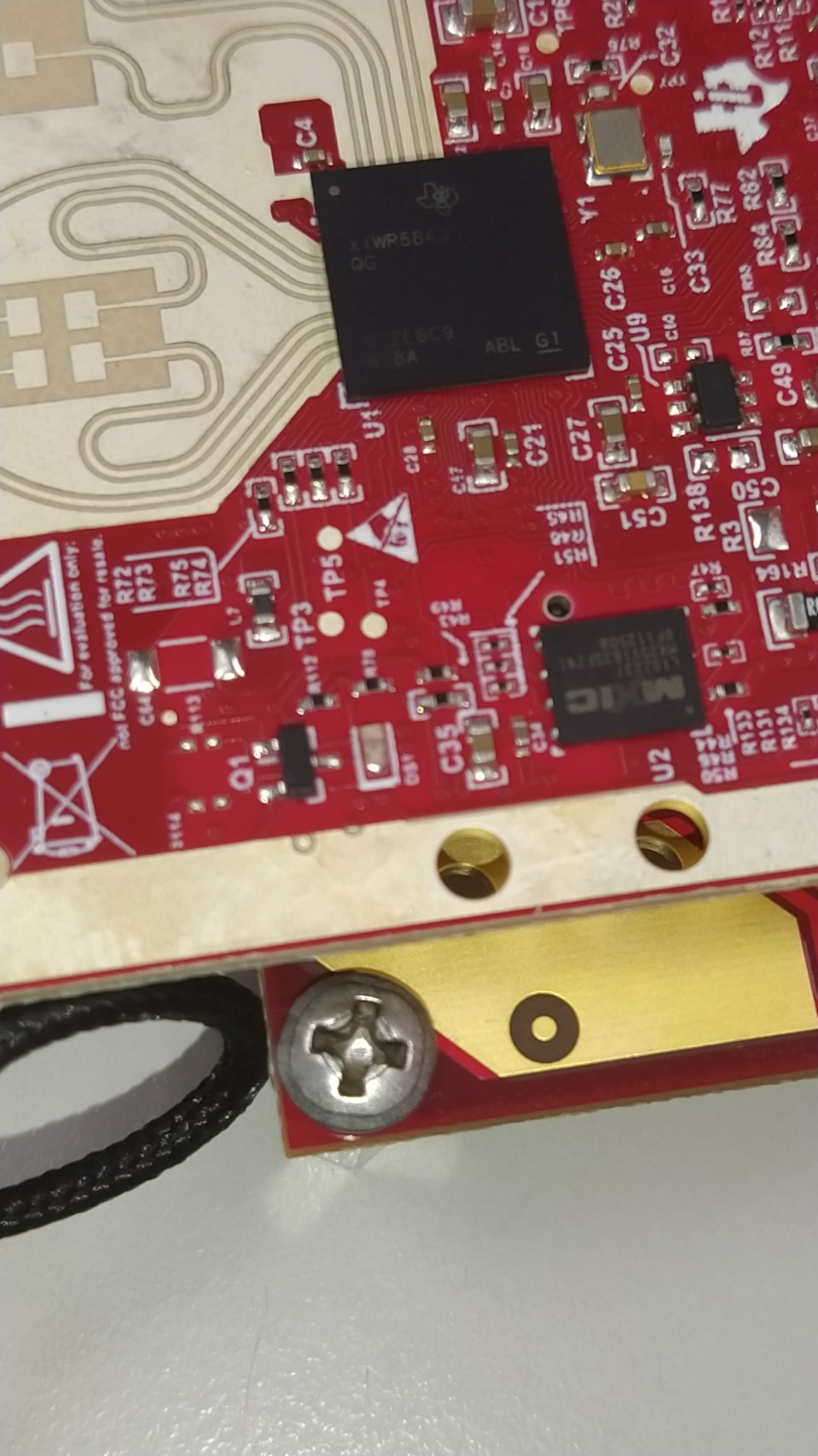

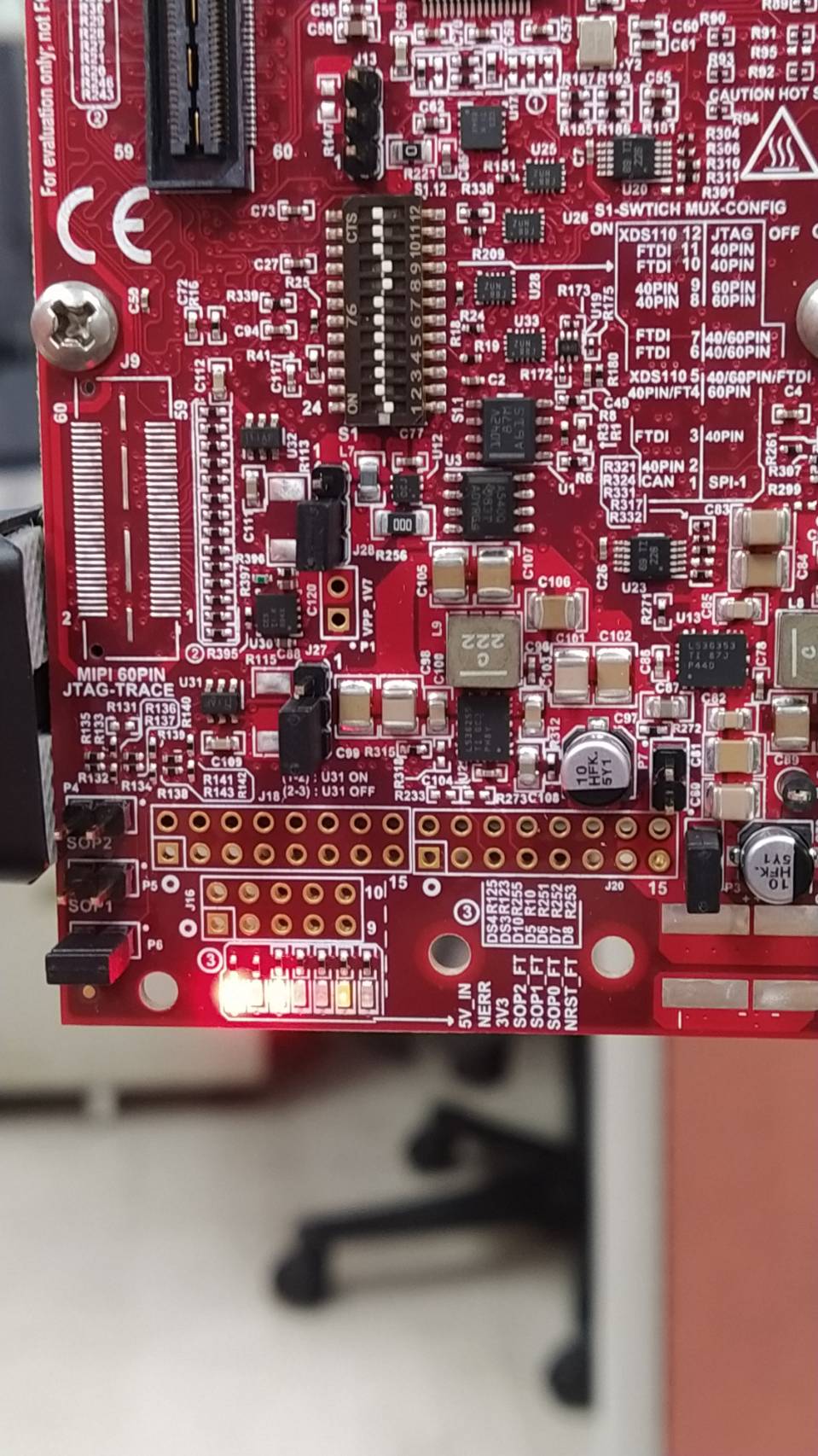

  • Hi Connor ,
     I know the COM port which one is for data and which one is for configuration and I think the COM port Nubmer there in visualizer setting  I choose with no problem (with the default recommend baudrate).
     I did and followed by the instruction on document .Also I take the picture of the board below.  SOP2 set to be opened (function mode ).

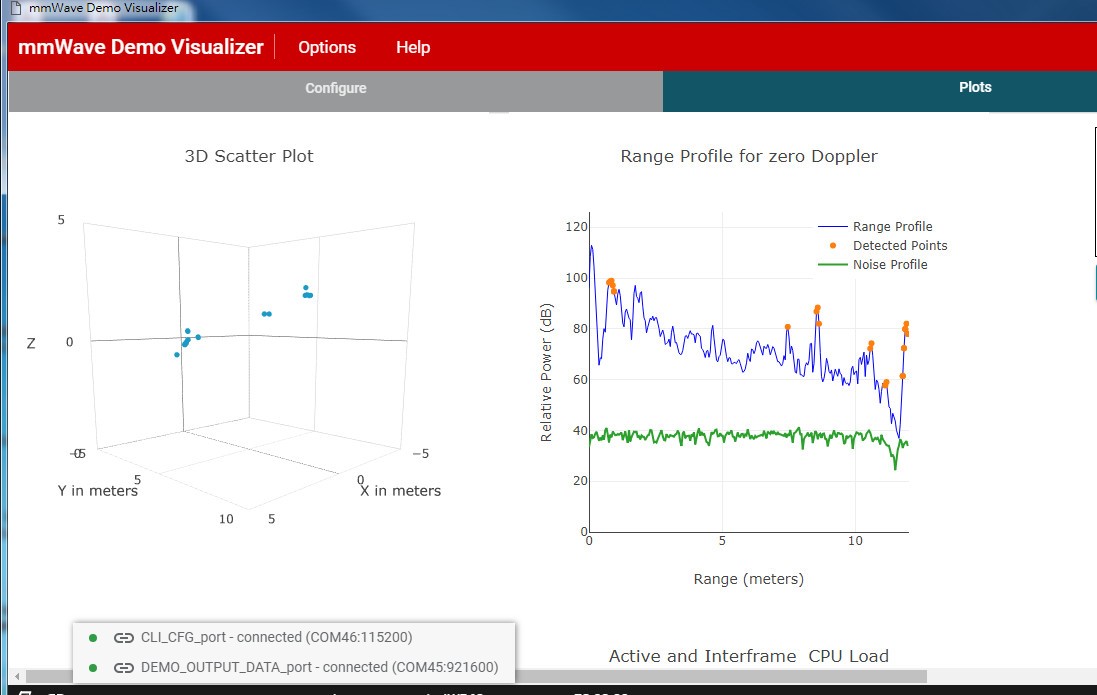

     The problem now is at DATA PORT showed Connecting (COM45,921600 , waiting for data) , we got no data .
     Please help guide us quick rule out this problem . thank you.

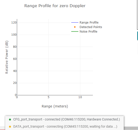

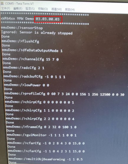

  • Hi Vaibhav ,
      1. the dataport status of the GUI are not connected .. it's in connecting.
      2.  I can't see the data come from dataport from console , but CFG port is OK , I can send command to EVM.
      3. yes , that OK in Area sacanner Demo .
    Might this issue from firmware binary ? can you provide the fix steps .
    I need to develop the algorithm in the topic  "Detecting Human Falls and Stance with IWR6843ODS".
    please help give a guide and the reference project should be working on my hand kit.
    thanks.
    Ben.

  • Hi Vaibhav,
    my tryout result below:
     1. Other PC have same problem (I have tried on both Win10/win7 OS). My visullizer is installed the offline version , also I tried both online/offline network with same problem.
    2. For connecting via consle  ,
         -CFG port is OK , I can send command and got response to EVM
        - but I can't see the message from data port.
    Ben.

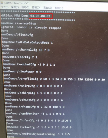

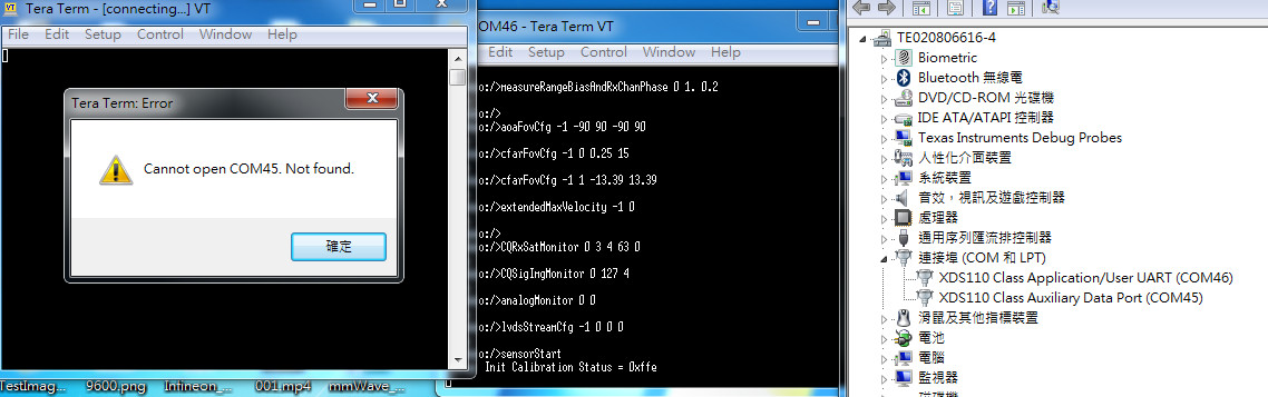

  • Hi Connor and Vaibhav,
     Thanks , Vaibhav support...
     I upload my test video ,
    I followed the eailier Vaibhav post instruction.
     (Note. his work in ISK device and flashed  binary  "03.04.00.02" , it's not my using version and device)
    1)  I send command as in "profile_iwr6843_ods_3d.cfg" from CFG port using TeraTerm.
        but after sending sensorStart command ,I can't see the bunch of nonsensical characters respnse from data port using teraTerm.
    2) The binary SDK version was flashed to my device  as showed  below :
       3)it's ODS ES2 device.
    Ben.

  • Hi Connor ,
     1)I have upgraded to industrial Toobox(4.3) , Visualizer (3.4) and SDK(3.4) for the OOB demo.
         Unfortunately, It still got stuck , the GUI show without point cloud data.
      2) I also check by TeraTerm , after I send chirp configuration command and send sensor start command ,  I could see the screen flash in Windows device manager due to com port re-connected  then the data COM disconnected in TeraTerm and can't be opened.
    3) Have you tried it in your side using ODS device ?
    4) Please report  to TI engineer  , and tell when will have fix
    Ben.

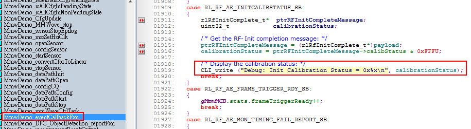

  • Ben:
    I have ran the ODS demo personally following the instructions given in the User's Guide and got the demo to function properly.
    The next steps are as follows:
    1. From your last screenshot from Tera Term I can't see the final Done after "Init Calibration..." so please verify that it is there or is not.
    2. Use CCS to run the demo as prescribed in the Developer's Guide in the Demo's User Guide. This will use to better isolate where the problem is.
    Let me know your results and we will go from there.
    Connor Desmond

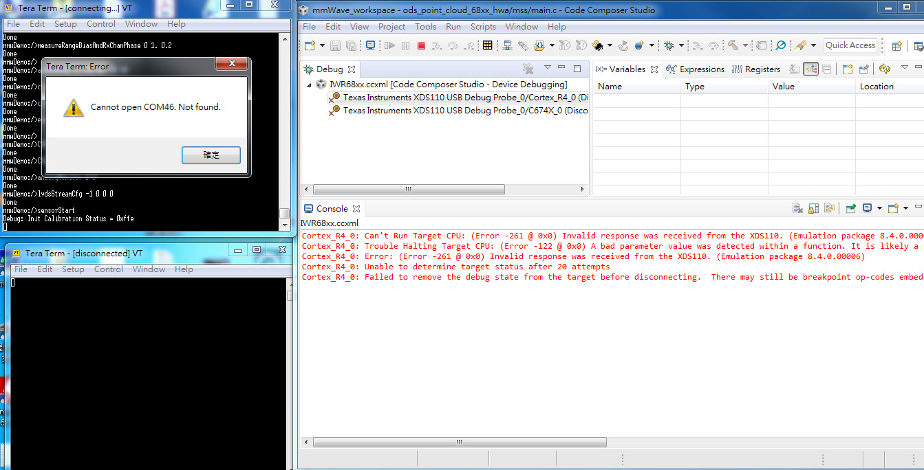

  • Hi Connor ,

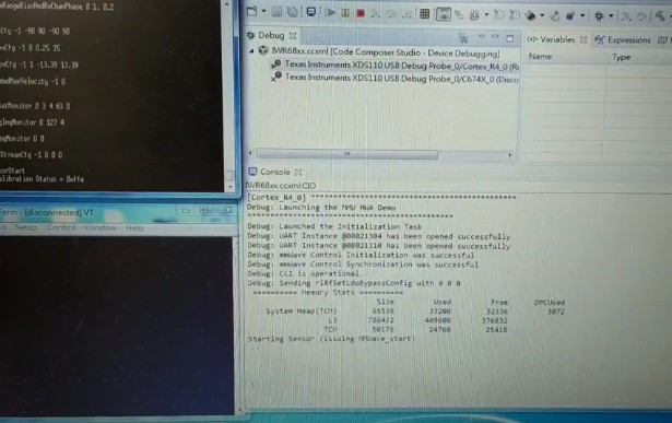

     1) Below is error in CCS debug console , and the debugging as in attaching video.
    Cortex_R4_0: Can't Run Target CPU: (Error -261 @ 0x0) Invalid response was received from the XDS110. (Emulation package 8.4.0.00006)
    Cortex_R4_0: Trouble Halting Target CPU: (Error -122 @ 0x0) A bad parameter value was detected within a function. It is likely a problem with `SC_ARGS' in SMG_call(). (Emulation package 8.4.0.00006)
    Cortex_R4_0: Error: (Error -261 @ 0x0) Invalid response was received from the XDS110. (Emulation package 8.4.0.00006)
    Cortex_R4_0: Unable to determine target status after 20 attempts
    Cortex_R4_0: Failed to remove the debug state from the target before disconnecting. There may still be breakpoint op-codes embedded in program memory. It is recommended that you reset the emulator before you connect and reload your program before you continue debugging
    2) For your Q1 , Where is the code line you said the "final done" ? I only find  the return of "Calibration status" in Mmwave_eventCallbackFxn()@main.c .
        and What is the calibration status : 0xffe meaning ?
    Ben.

  • Hi Connor ,
     I try it but that still not work.  What is the ok done back log from debug console ?  can you post it..
    Below is the final log in debug console before the COM port show disconnected.
    Ben.

  • Hi Connor ,
    I just have anther thread for other demo debugging , I got the suggestion to change my power adapter ( caused by my adapter 5/v/3A is not good quality, not enough to 3A)
     this issue is resolved , I can use this point count demo , thank for your help and support.
