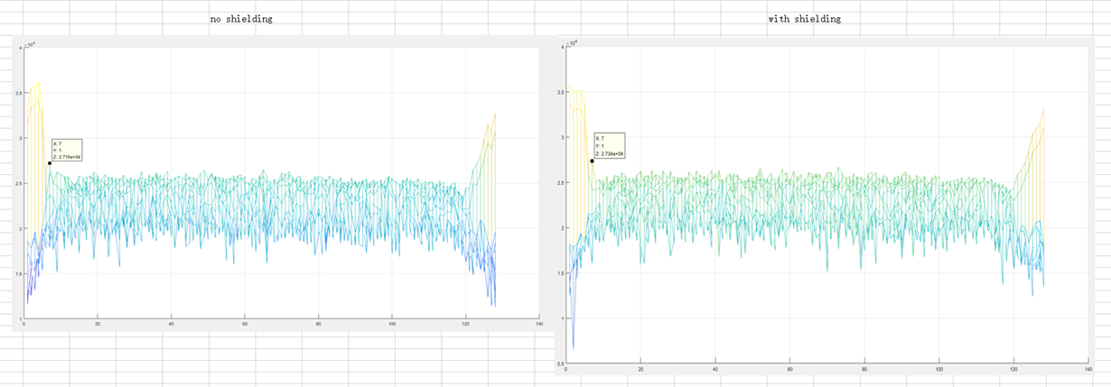

in the 2d ffd , we found some jamming the the index 0-4 . How can we reduce it?

Hello ,
Close to DC bins there will be signal present due to Tx to Rx antenna coupling. You could possibly try to cancel this signal in your processing by reading the coupled signal and cancelling this signal from all data after that.
Vivek
