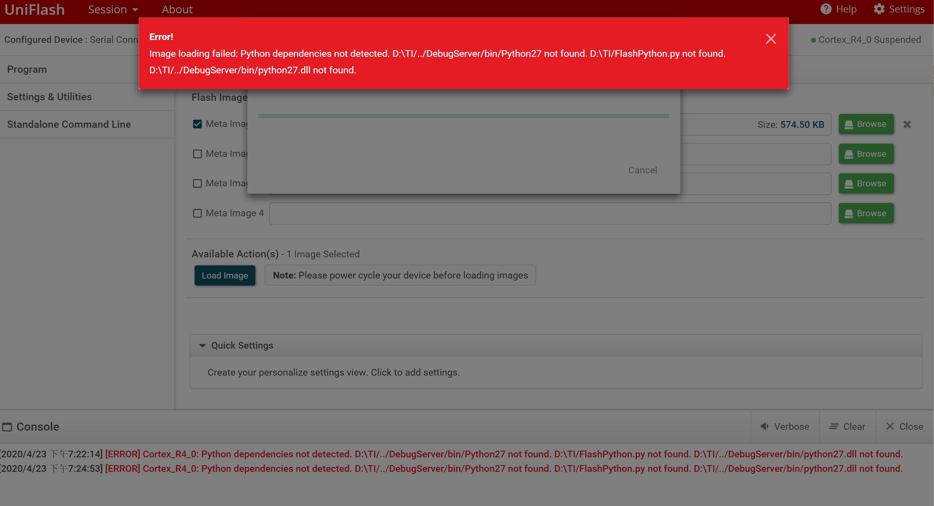

Part Number: AWR1642BOOST
Please uninstall your current Uniflash and reinstall using the latest version found here: http://www.ti.com/tool/download/UNIFLASH
Please make sure you install it to the C:\ti directory
There may be problems with you installing it to the D:\ directory
Kyle
