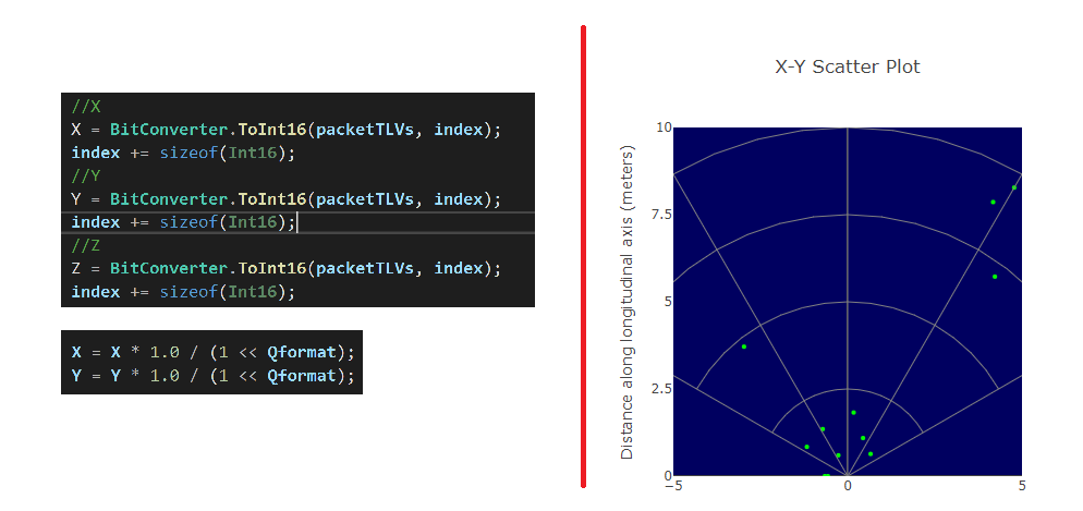

in my application I am trying to get XY coordinates from IWR1642 device, reading from DATA_port UART; I am able to read and deserialize header (for example coherent magicword=0102-0304-0506-0708, version=02000004, platform=000a1642, TLVtype=1, Z=0, etc; hence I would exclude endianness issue) but the strange fact is that I am not getting any X negative value. Conversely, while running DemoVisualizer I actually have some negative X points:
am I missing any additional transformation/conversion?
Example:
...[4F][01][28][01][00][00]...->
X=335,Y=296,Z=0 (int16)
X=0.6542969,Y=0.578125,Z=0 (float)
