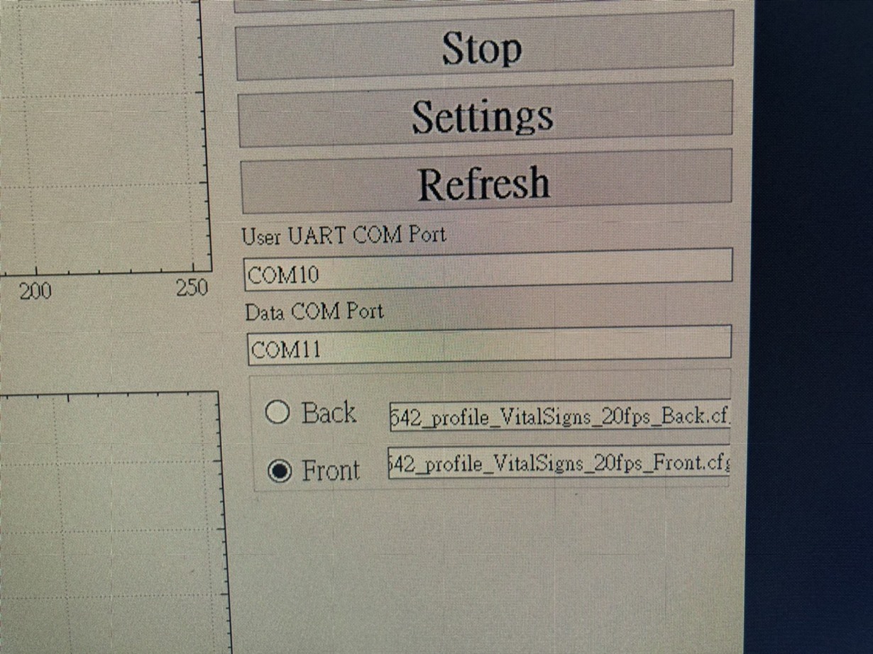

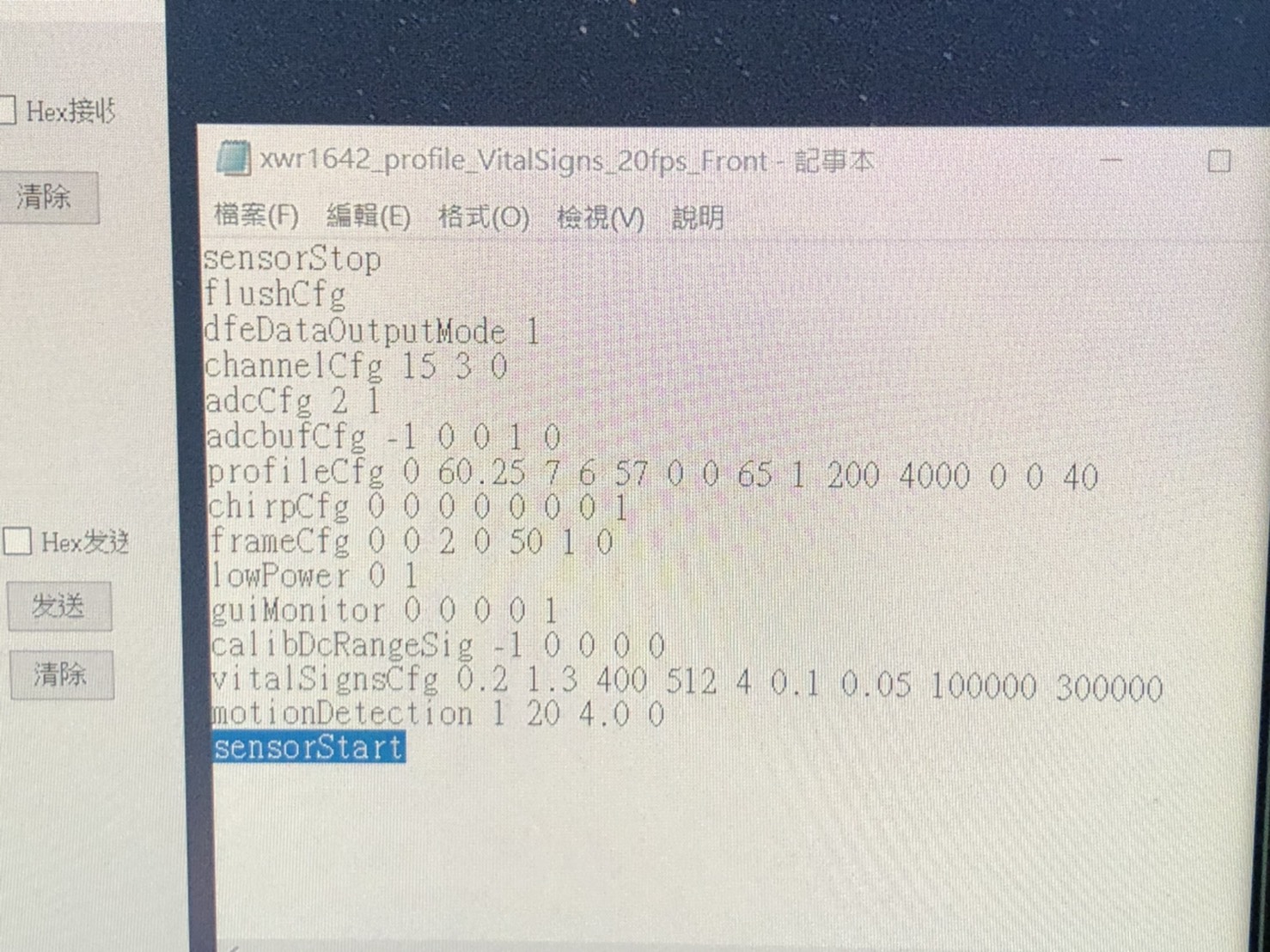

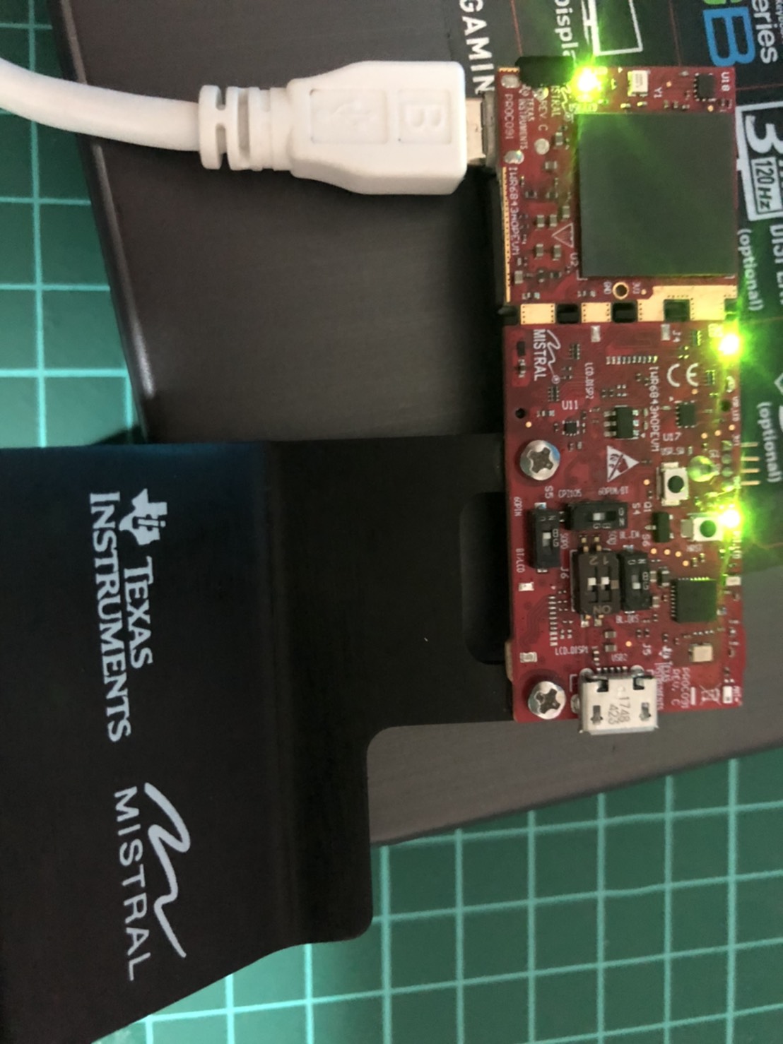

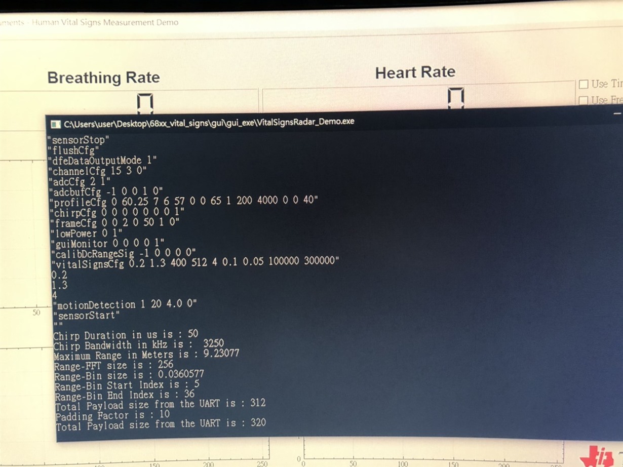

               We run vital sign lab on 6843AOP EVB  but always NG . We don't change any thing and this module can run  other labs normally .
               We show some information for  reference . Can help  to find out what is the root cause ? IC issue or  application lab sensitive to use ?
                Our boss try many module for verifyt his but vital sign lab is sensitive to PCB hardware. ,
                now we verify TI mmwave AOP EVM  the result is can't work , It's means vital sign only for demo use  ?

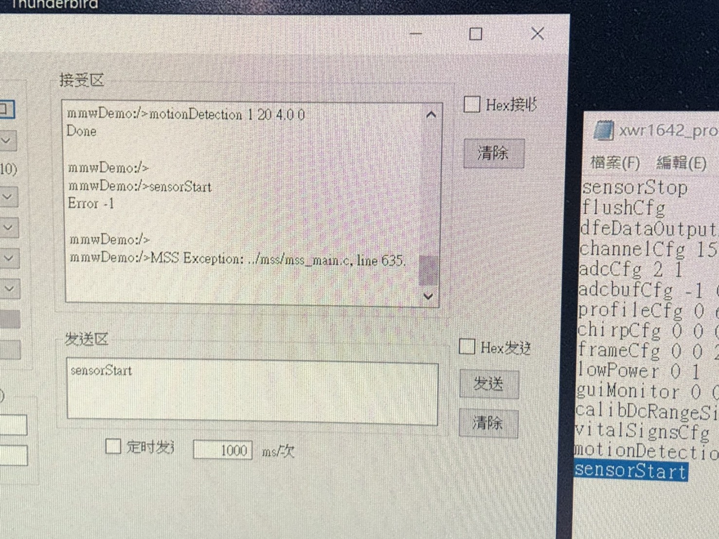

                Error message shows at mss  line 635 .
