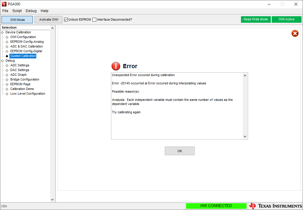

I have got a problem about PGA300 calibration. The error is in the below.

Hello Ibrahim,
After what step in the calibration do you see the error? The most likely reason is that there is something incorrect in the configuration file. Can you share the configuration file you used for this calibration?
Hello Scott,
I get the error after activating OWI in "Guided Calibration". The Calibration file is in the attachment.
https://e2e.ti.com/cfs-file/__key/communityserver-discussions-components-files/1023/Calibration-Settings-_2D00_-3P1T-_2D00_-Voltage-Mode-_2D00_-0-to-10.ini
Hi Ibrahim,
It looks like the problem is in the configuration file. You currently have your Calibration Mode set to 3P-1T. However, for your Temperature Points and your Pressure Points you have 4 points each. If you would like to use 4 temperature and 4 pressure points, you should set the calibration mode to 4P-4T.
Additionally, for the DAC data, you only have 3 output points. Typically you would use 4 points if you have 4 pressure points. Each DAC data point will correspond to one of your pressure points. If the number of points is mismatched you will not be able to perform the calibration.

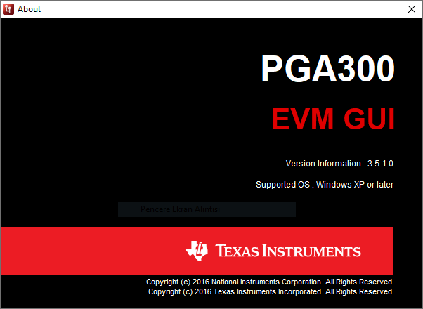

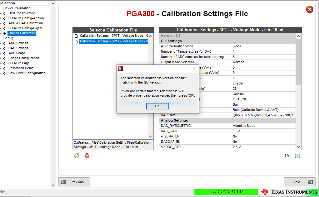

What version of the GUI do you have? The version on the PGA300 page is the latest, and it should include the following calibration setting files, which will work with the GUI.
Hi Ibrahim,
That is the latest GUI version. The configuration files have their own version number, so it will not necessarily correspond with the PGA300 GUI version. Were you able to try the configuration files I included in my last post?
I've tried. But the situation is unsuccessful, I get the same error again.
