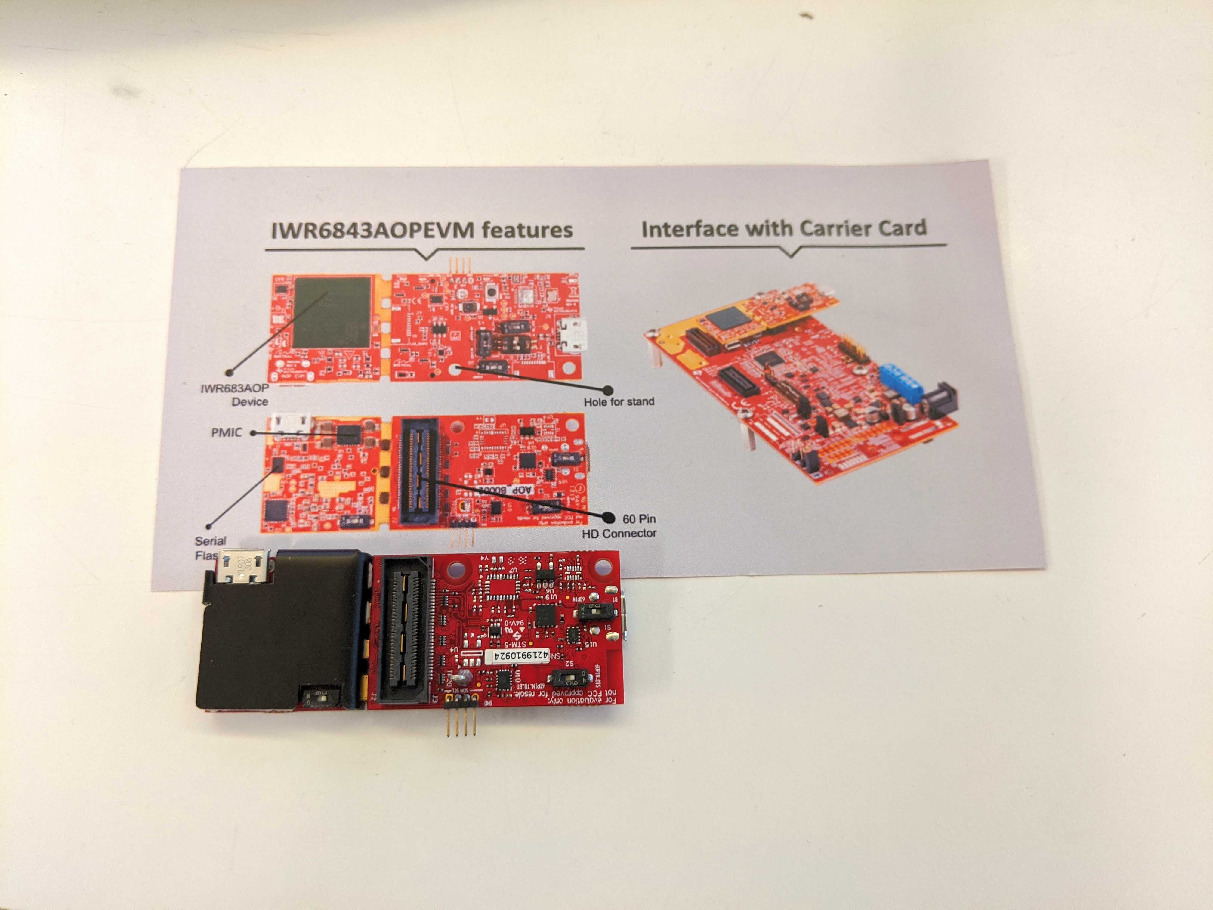

We are having issues with the TI mmWave carrier boards. The IWR6843AOPEVM we received has an unexpected heatsink on it that is totally in the way, making it impossible to mate with the "MMWAVEICBOOST" carrier board. I've attached the images below showing the problem:
How are we supposed to do anything with this when what we received doesn't match their own documentation?
    This issue will be resolved on the upcoming rev of the board.
    Although it is strongly recommended, the Heat sink is not a mandatory requirement for the EVM use.  Due to the smaller size of the IWR6843AOPEVM it is likely to get warmer than other larger sized EVMs on the mmWave Radar portfolio, therefore care needs to be taken to ensure the junction temperature does not exceed 105 deg C.
    The plot below shows measurement of junction temperature vs duty cycle taken with and without the heat sink. As seen in the plot the EVM can safely operate up to 50% duty cycle without the heat sink.
