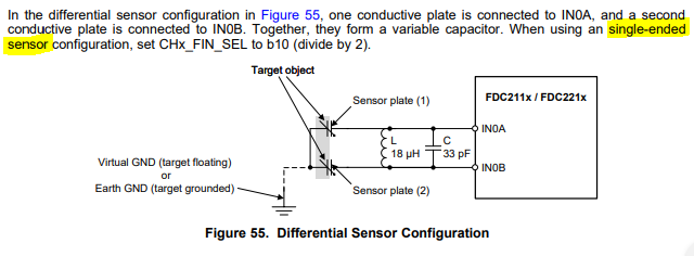

We have a customer that brought this to our attention:
The screenshot is from the datasheet, page 39. May we please request for confirmation if this is a typo? Should it be "when using a 'differential sensor' configuration" instead?
Thank you,
Elisha
  • Hi Elisha,
    This is not a typo. The information is correct; it is just placed in a somewhat odd spot next to the differential information. Please reference Table 1 for the recommend CHx_FIN_SEL value for the differential sensor configuration.
