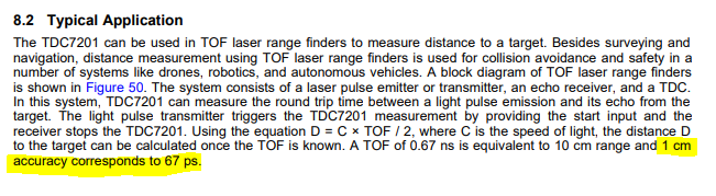

  • Hi Akeem,
    Getting back on this. The confusion came from the Section 8.2 of the datasheet shown on the attached image where 1cm accuracy was given. Can you confirm if device is indeed capable of 1cm measurement?
    Thanks in advance!
    Art
  • Art,
    The highlighted sentence refers to step resolution (accuracy), not minimum range. The TDC7201 has a step resolution of 55ps (rounded up to 67ps is 1cm in distance), meaning if the minimum distance that can be captured is 3.75cm, the subsequent distances that can be captured are 4.75cm, 5.75cm, ... etc.
