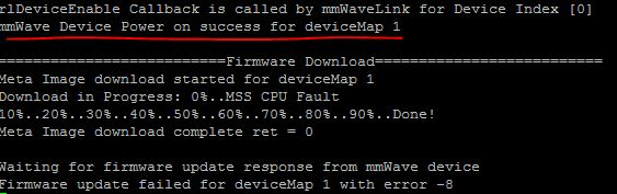

I am testing our two chip cascading solution with AWR2243 board.
Now I try to download the firmware to master AWR2243 through SPI interface, as
long as the host send the first trunk to device, the asyn signal "MSS CPU Fault " is received:
However, the device can be powered on successfully as shown in the red line.
BTW, I do changed firmware type to 0 as shown it the following:
/* Firmware File Type */
#define MMWL_FILETYPE_META_IMG (0)
Any ideas?
