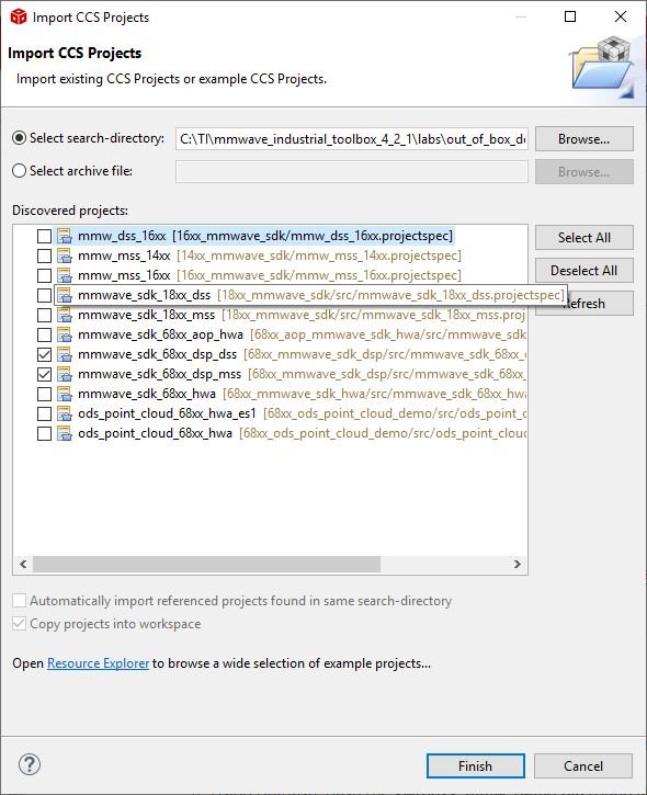

I'm trying to rebuild mmwave_68xx_sdk_dsp_demo with SDK3.04.03.03 in order to verify RF calibration function in new radar firmware.
first I import demo program from industrial tool box 4.2.1.
The default is using SDK 3.3.0.2. I can build and run it successfully.
I simply change the SDK version from 3.3.0.2 and 3.4.0.3 and replace radar image to xwr6xxx_radarss_rprc.bin in folder C:\TI\mmwave_sdk_03_04_00_03\firmware\radarss

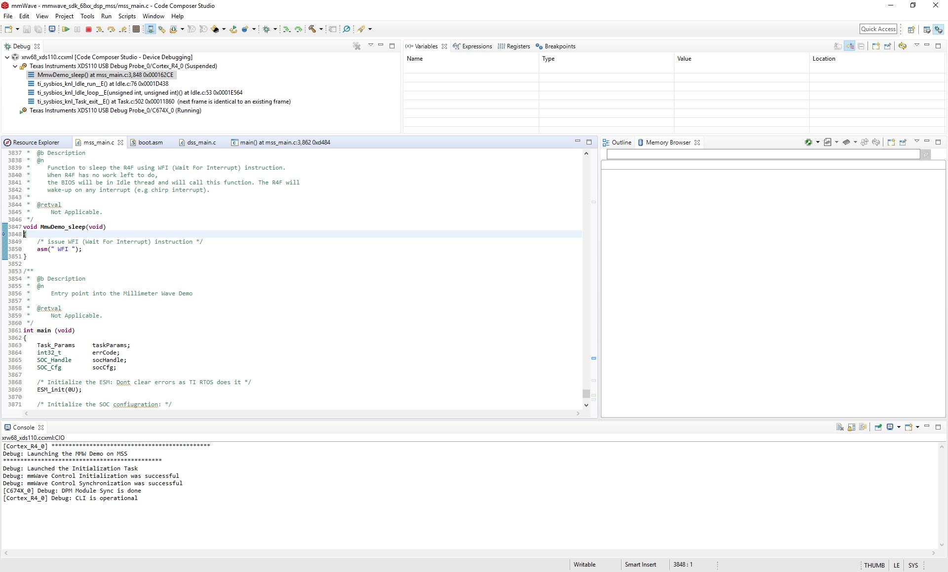

I can compile and link to get image successfully,after download to 68xx ISK, I also see promot: "CLI is operational". However, I get no response when I trying to download configure file. CCS debug shows MSS R4F is under sleep mode and running idle task.

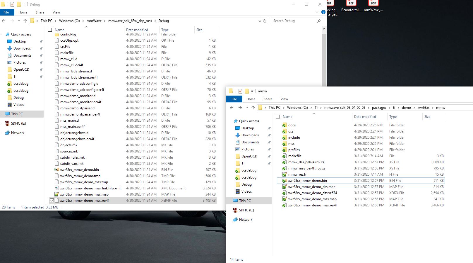

I compared the size of compiled image and pre-built image from SDK. The code size is different.
The prebuilt image runs well without any issue. I'm wondering anything missed if I need to use SDK3.4.0.3?
