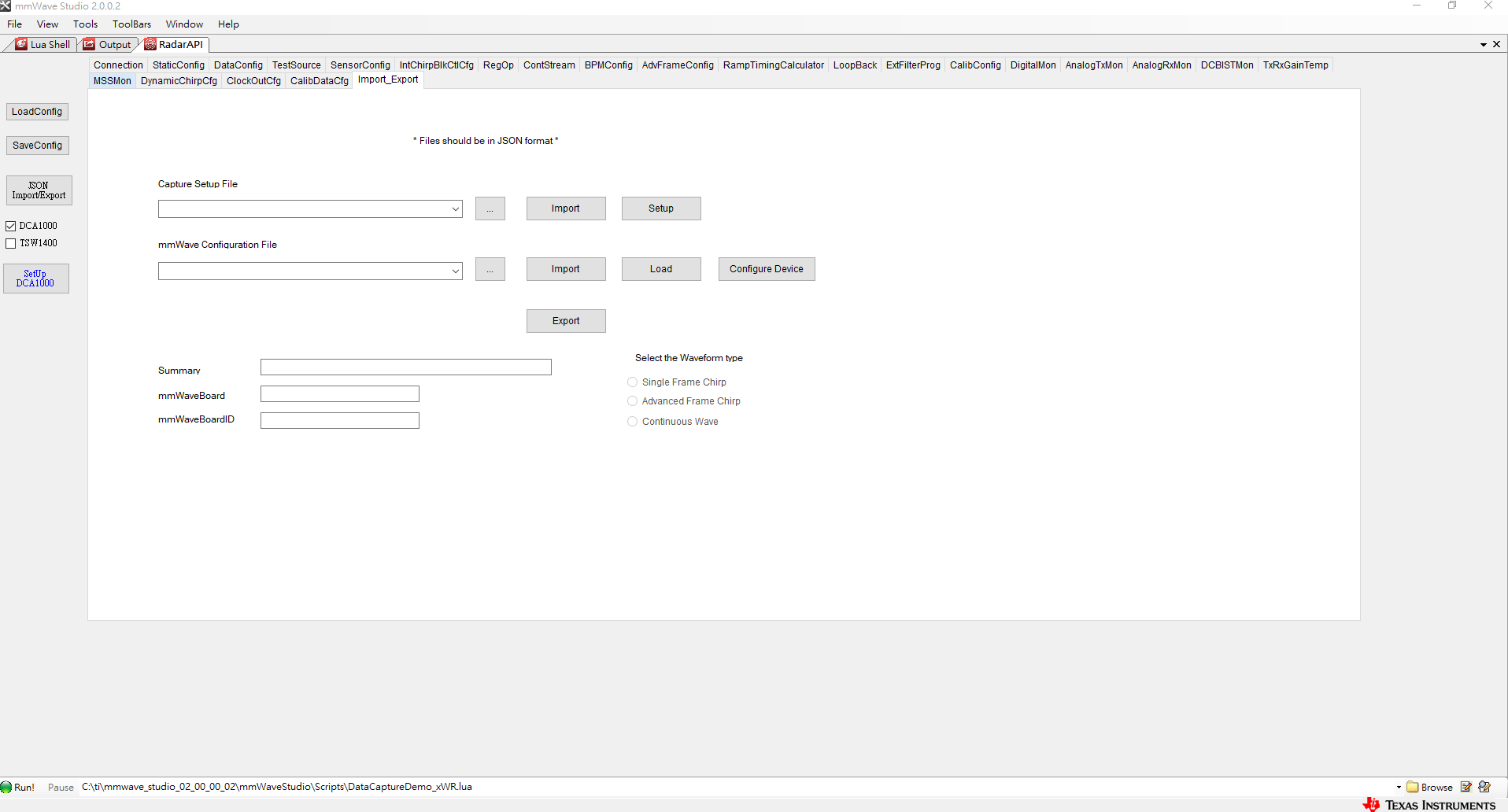

I'm using iwr6843+DCA1000 for data captured.
I want to export the the json file after setting the parameter via mmwave studio. I know the studio GUI can export the json on Import_Export tag as following
The setting in GUI could be transform as ar1.function, so I try to convert this behavior to ar1.JsonExport as line 46:
However, the export setup.json will lose part of DCA1000Config information, which I have set (above picture).
Comparing json below:

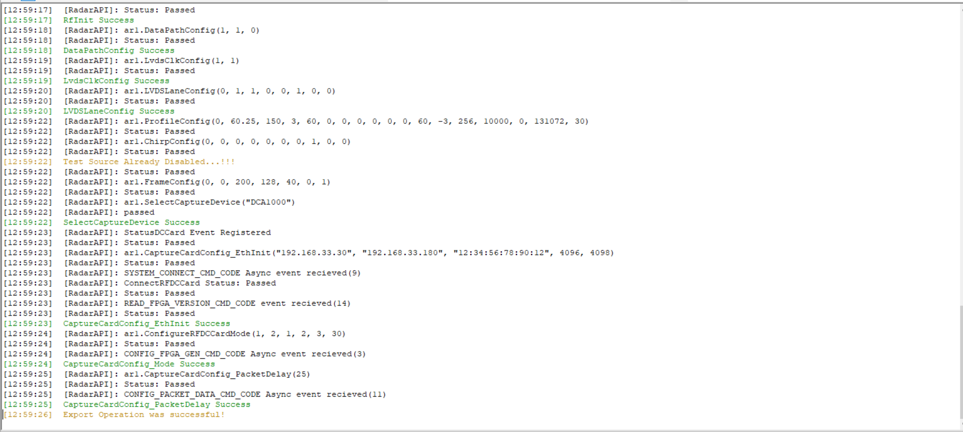

  • Hi Zigang:
    I have check the DCA1000 configure command on Studio output screen, and the output is as following:
    It seems that the DCA1000 has been set as we wish.
    However, the JSON file still lose the DCA1000 Config structure.
    We're using Matlab to control the Studio. Due to the using requirements, we separate the lua scipt into three parts. Does it cause the issue of JSON file?
    Best
    Ernie

    I finally get a DCA1000 board to try myself.  It does show the similar information as yours.   I then went back to the users guide, and it does not mention that the json file will contain the IP address configuration for DCA1000.
    Zigang
  • Hi
    Yes, all the experiments are controlled by Matlab and run by studio GUI.
    Does this issue cause by controlling with Matlab?
    Ernie
  • Hi, Ernie:
    I tried the export json file and I did not see any DCA1000 IP address setting either.   It is not due to the MATLAB control because I am using radar studio GUI interface.
    But when I went back to read the radar studio users guide, it does not mention that DCA1000 IP address setting will be included in the json file. So the information, you think is missing, is never plan to be included in json file.
