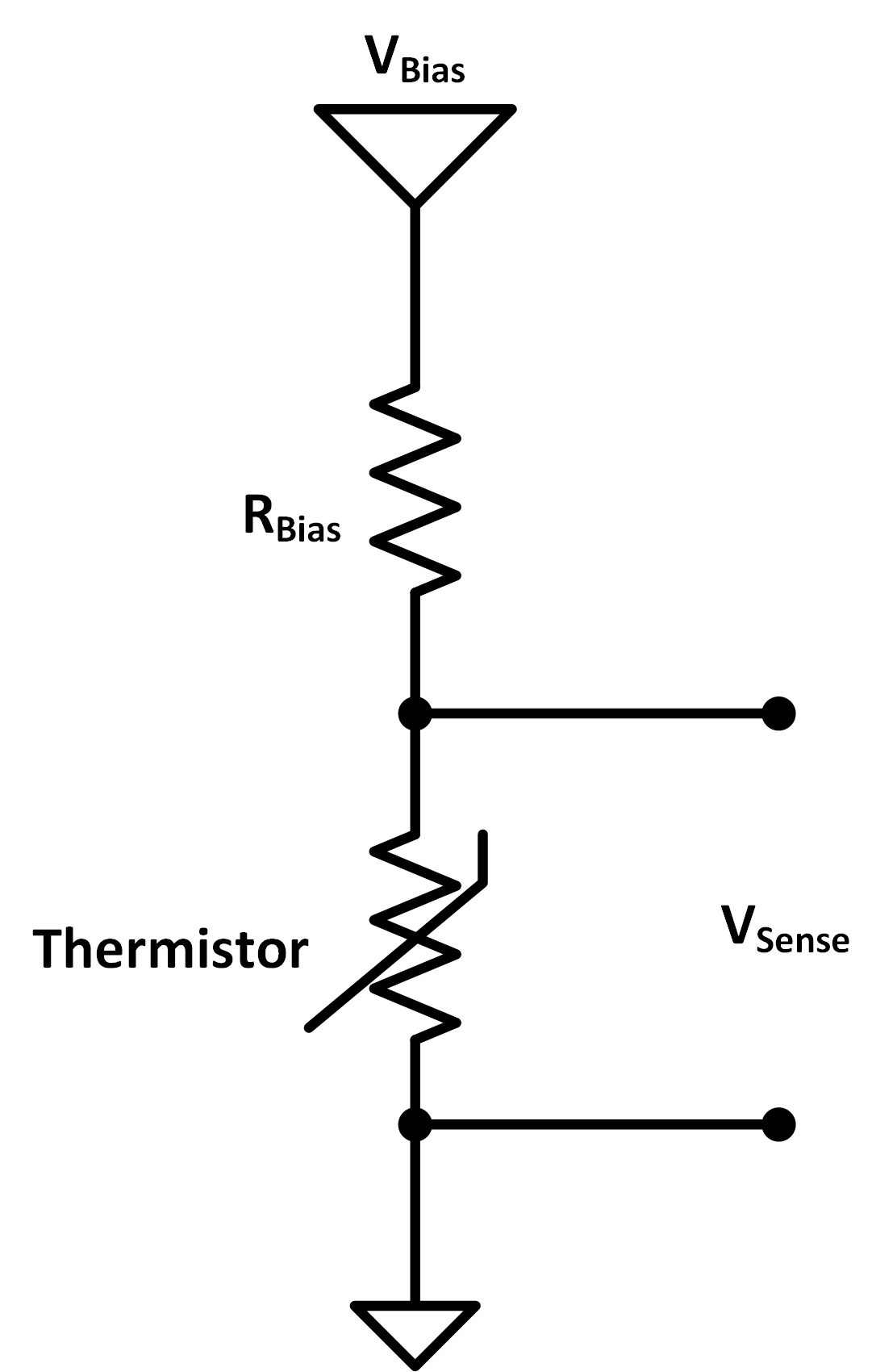

  • all of our linear thermistors have a positive temperature coefficient. The normal way to design in one of our thermistors is with an Rbias resistor on top of a voltage divider. However is you reverse the divider circuit and place the thermistor on top and the Rbias resistor on bottom, the output will be a linear negative temperature coefficient. you can also reverse an NTC and get a positive temperature coefficient response.
    Most of the formulas are basic ohms law type of formulas. Sensitivity is just measuring the delta resistance between 1C temperature steps.
    Power is P=V*I, the current is determined by determining the resistance of the thermistor, then add that to the Rbias resistance for a total series resistance. Then I=V/R. Divider resistance is Vdiv=Vcc - (Rbias * I).
