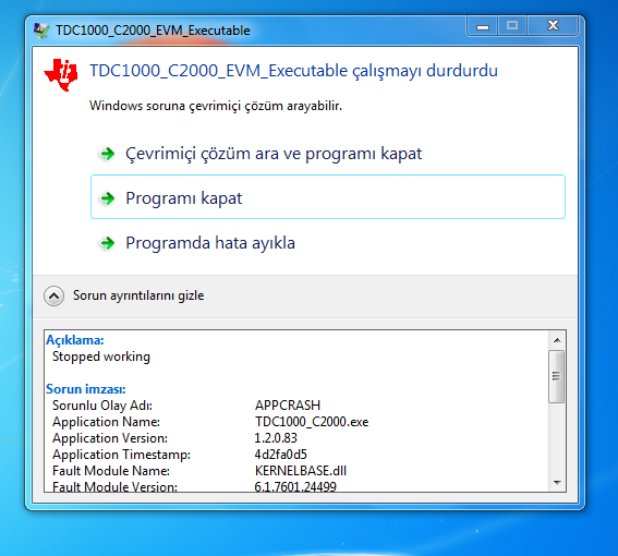

I successfully installed the TDC1000-C2000 EVM's GUI with the version of 1.2.0.83 and with following the steps in the board's User's Guide documentation but when i click to run the application, it says "TDC1000_C2000_EVM_Executable has stopped working". I confirm that all the setup files downloaded successfully with no errors. My operating system is Windows 7 (64 bit). Tried to remove and install the GUI again but i have still same error. Also tried to run on Windows 10 (64 bit) and Win 7 (32 bit) but result is same. As an additional solution, tried to run as an administrator but again, application is not running with same error. With the solutions above i could not make it to the result. I am adding the screenshot of what i am getting as an error.
I appreciate any help.
Thanks.
    Could not add screenshot to my main question, I am adding this with a reply.

  • I successfully solved the problem with changing the operating system's language to English.

    Thank you for reporting the GUI requirement to set the OS language to English. We will add this note to the TDC FAQ.
