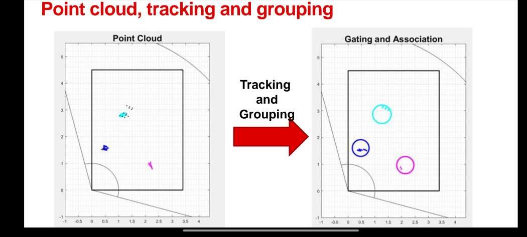

1)i have tried the 3D people counting firmware ,but i am looking for the firmware for the below GUI image for IWR6843ISK ,where can i find it  along with the visualizer.
2)Do i have to download the MATLAB runtime for the people counting demo ,or we can use the browser similar to  TI CLOUD BASED VISUALIZER ,if so how to use MATLAB runtime with browser?
3)can  we compile the source using Linux ,or there is only ccs?
  • Hi Rahul,
    1. You will want to download an earlier version of the Industrial Toolbox to use the previous GUI. I believe the Toolbox 3.3 should be appropriate.
    2. Only the Matlab Visualizer is compatible with the previous versions of the Visualizer. The current version in the Industrial Toolbox uses a Python GUI.
    3. Only CCSTUDIO is supported for mmWave Labs.
