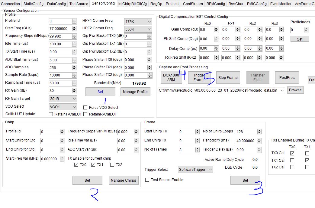

Hi Support team,
I see the following error messages when using RadarAPI to capture data using a DCA1000+AWR2243BOOST. I see these prints when working with the SensorConfog tab. I follow the steps in User's Guide for mmWaveStudio 3.0.0.7. Any idea what's going on?
Thanks, Daniel

  • Hello Daniel,
    You missed invoking frame config from mmWave Studio before sensor start. Please invoke this API then ARM DCA1000
    Optionally you can use the LUA script to execute all the step in one shot, refer mmWave Studio user guide for this purpose.
