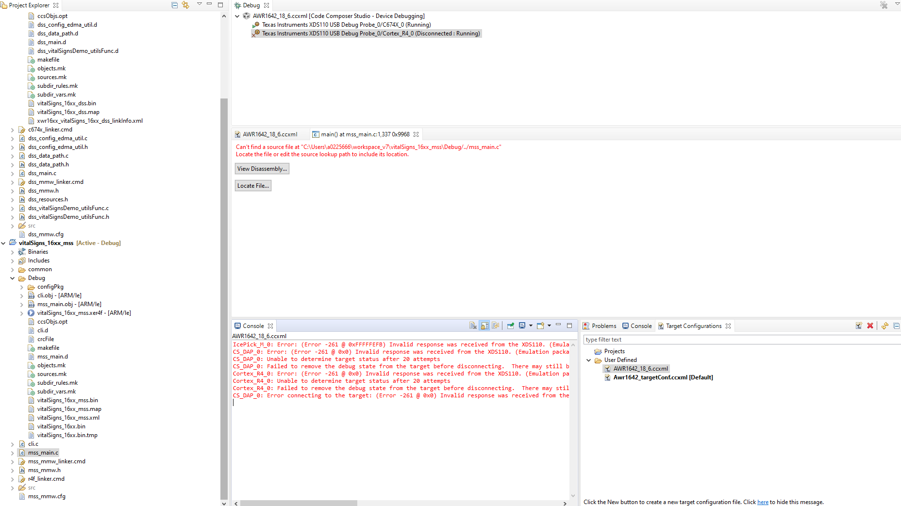

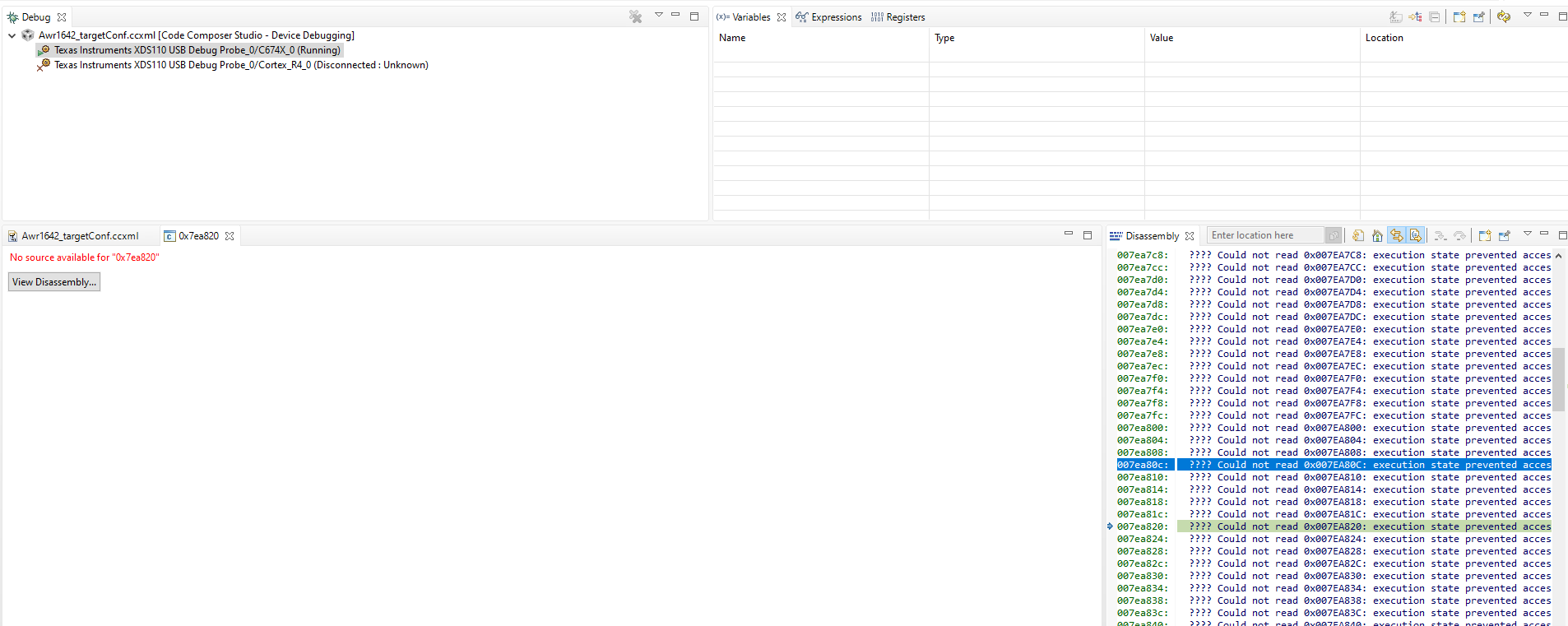

  • Hi Cesar,
    I succesfully connected the EVM and ccs , and it ran properly, but then after a while i recieved the following error. And now its not working:
    Kind regards,
    Aditi Karande
