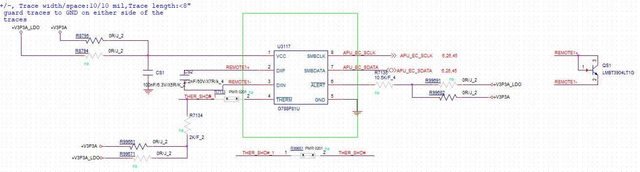

May I quick check with you, can I just replace G788P81U by using TMP431B as below?
Is there anything that need to be paid attention to?
Hi Penn,
TMP431b looks to have the same package and pinout. There is limited info on the G788P81U device so I cannot check for software compatibility.
David
