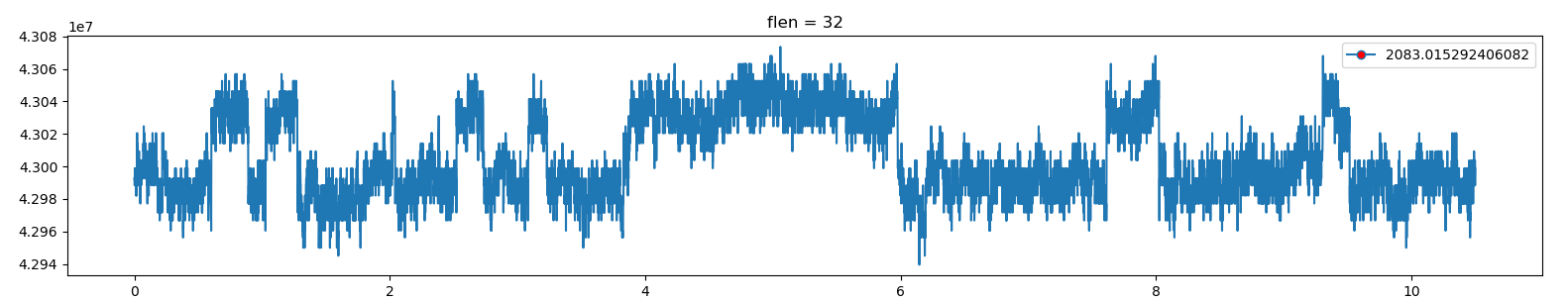

During testing, several measurements with a strange behaviour appeared.
The longer the measurement runs, the more signal jumps occur.
Around 10 to 15% of the measurements show this behaviour.
The signals are scaled in aF and plotted over time in s.

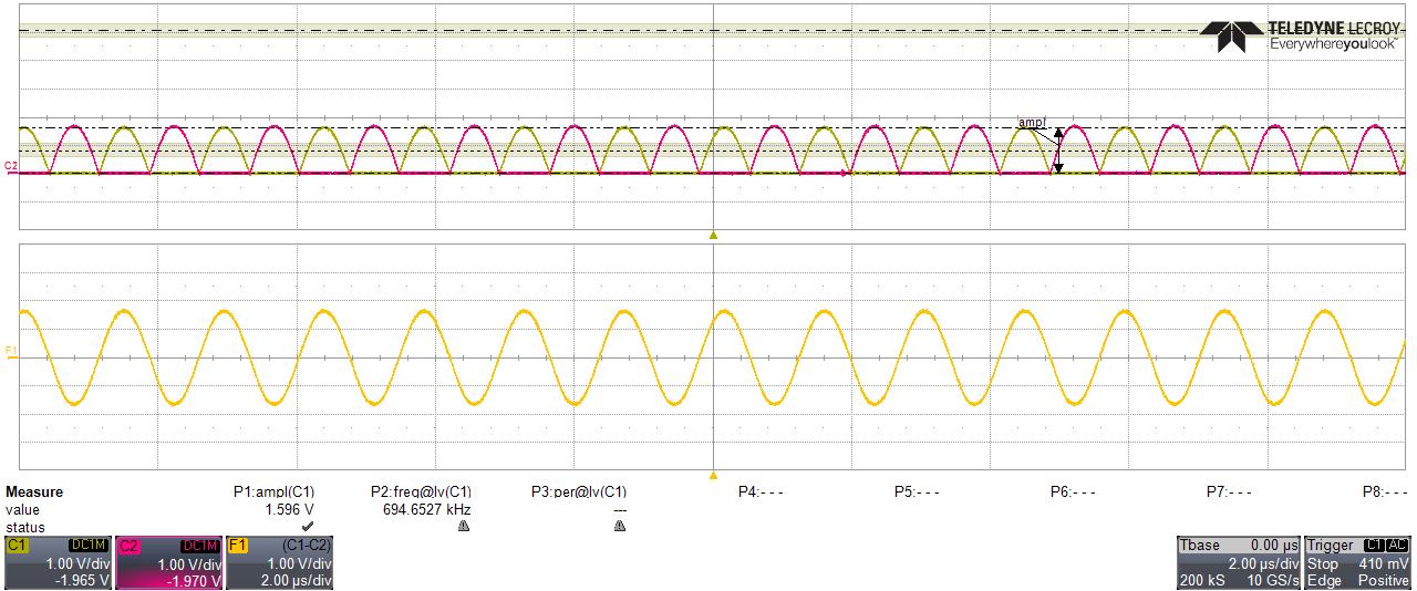

Setup: 220uH, 150pF, single channel, continuous measurement
