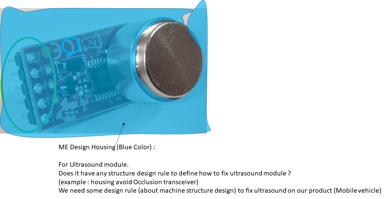

  • Akeem,
    Thanks and one more questions in below.
  • Hi Paul,
    TI does not have a document explaining the design rules of the mechanical enclosure/housing for an ultrasonic sensor. The customer should contact the transducer supplier for suggestions and guidelines on the mechanical housing.
    In general, the transducer should not make direct contact with the housing because this will impede and distort the vibrating mechanism. Typically, a flexible rubber gasket ring is placed around the side wall of the transducer to allow for a sealed contact with the housing. The rubber ring is flexible enough to allow the transducer to vibrate and prevent water/dust from entering to into the enclosure.
