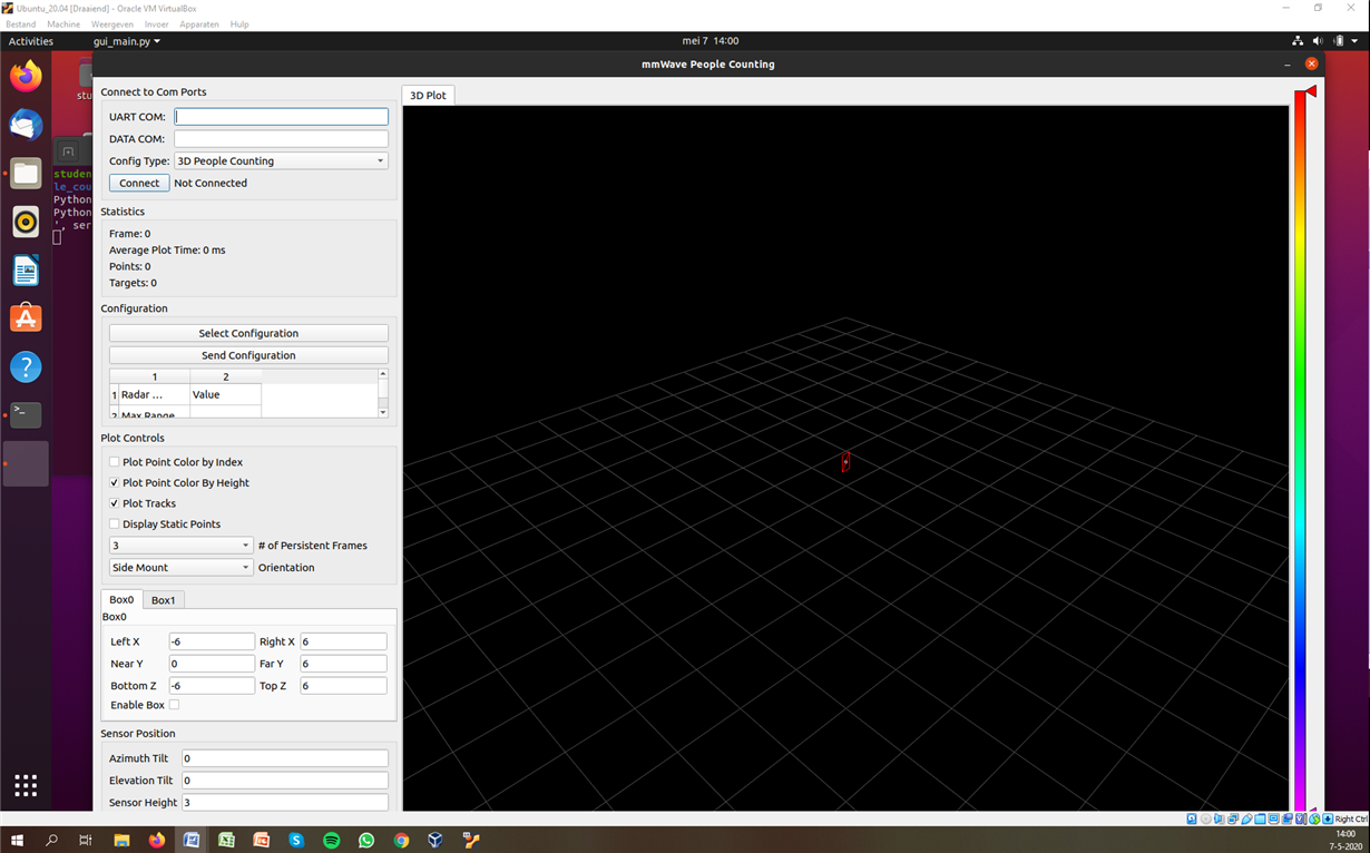

I am currently working with a IWR6843-ODS ES2.

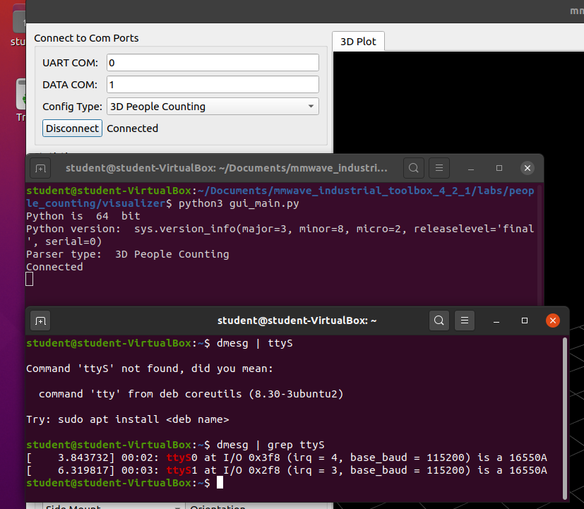

And i have a problem with the People Counting demo.
I managed to open the GUI on my Virtualbox with a Ubuntu_20.04 virtual machine.
I also managed to connect the COM ports to my VMs serial ports and see the connection in the GUI after i changed a few lines in the python gui_main.py file.

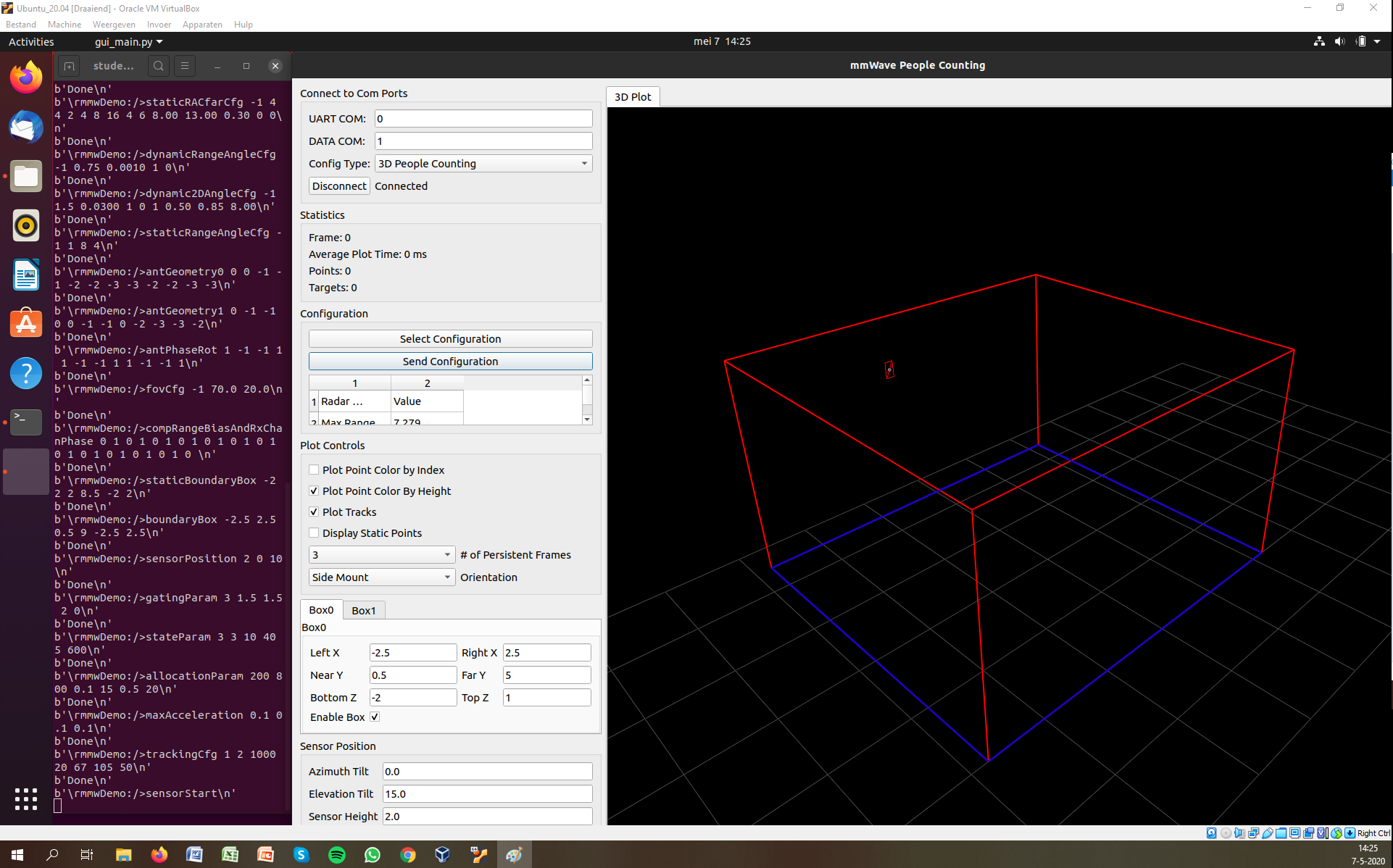

But every time i send the sensor configuration most of the time nothing happens.
Sometimes sending the sensor config works but the GUI display doesn't change a bit.
Empty GUI while sensor config is send.
Could you please help me out?
Best regards
Max

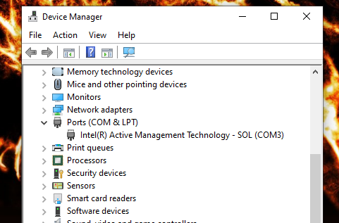

  • Hi Max,
    When you connect the device to the computer, do you see the com ports appear in device manager?
    Justin
  • Hi Justin
    I can see the device in my "Device Manager" when i plug it in:
    One strange thing that happened was when i activated the device in my VM:
    Than the device disappeared from my "Device Manager"":
    But i'm not sure if that helps, or if it happens because i activate the USB device and it has nothing to do with the COM port.

  • Hi Max,
    Typically, Virtual Box supports USB input, but we haven't tried it at TI.

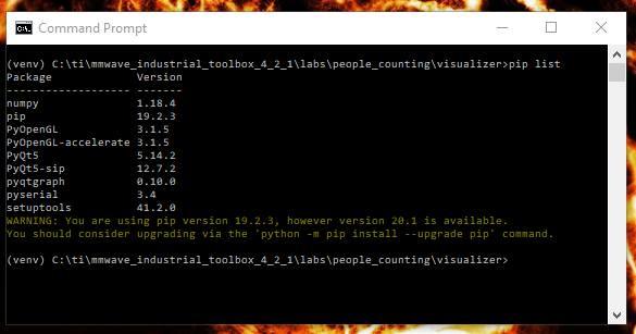

    From your previous post, I thought that there was another python package on your system that could be interfering with the visualizer, which is why I recommended using a virtual environment in python - this is not a virtual machine, but simply a fresh python environment. You can then install the dependencies to the environment and test the visualizer. See this page: https://docs.python.org/3/library/venv.html Did you get a chance to try this?
    Justin
  • HI Justin,
    I tried to use the GUI in a Python "virtual enviroment" (venv).
    The installation of the dependencies went well, but i had to change a bit of code in pytygraph that gave a "Module Time has no Clock Error".
    And i had to install pyopengl_accelerate because pyopengl gave a "NoneType object is not callable Error".
    But i got the same python error that i couldn't solve that says "error=1282, invalid operation" and i think it also come from opengl.
