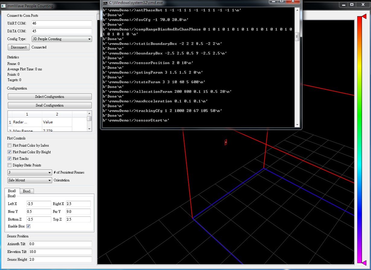

I have stuck for long time for getting start with the dead EVM,  due to the data port connection problem ,
Please give me the correct information that I can run these demo even the old version working that's ok and please help to fix it ASAP , and when will be fixed.
don't want to get such issue again in each trying of different version downloaded and evironment installed ,thanks.
 My hand on EVM : mmWaveBoost+IWR6843ISK-ODS
 and setup are as lists:
  -EVM: mmWaveBoost card + IWR6843ISK-ODS (ES2 device)
  -Toolbox:  mmwave_industrial_toolbox_4_3_0
  - GUI: mmwave_industrial_toolbox_4_3_0\labs\people_counting\visualizer
  - Binary file:   3D_people_count_68xx_demo.bin  @mmwave_industrial_toolbox_4_3_0\labs\people_counting\68xx_3D_people_counting\prebuilt_binaries
  - Chirp :       ODS_6m_default.cfg    @mmwave_industrial_toolbox_4_3_0\labs\people_counting\68xx_3D_people_counting\chirp_configs
The issue as below :
1) The 3D People demo can't get point cloud data from data port after I send configuration file and the startSensor command .
2)Verified by using the TeraTerm , I have Opened both Data COM & config COM port ready .
   When I send the chirp configuration command and send startSensor command , both Com ports were disconnected and disapearred in device manager.

  • Hi Justin ,
     1) The OOB demo in ToolBox(4.3) is not working also , please see my last comment  in another thread..
    2)I will get start to debug in CCS , but I think this demo should working in Toolbox pre-build release first.
       Please report the issue , thanks
    ( note. I have the success in other demo working like scanner area and vital sign in Toolbox(4.2.1) , the board & PC combination is not the problem)

  • Hi Ben,
    I have done some debugging internally, this error seems to be caused by inadequate power delivery. The power source needs to be 5V 3A - what is your power source?
    Justin
  • Hi Justin ,
     1)My power source adapter 5v/3A  is not good quality not enough to 3A , So I buy a new one and that's ok to resolved my head post issue.
