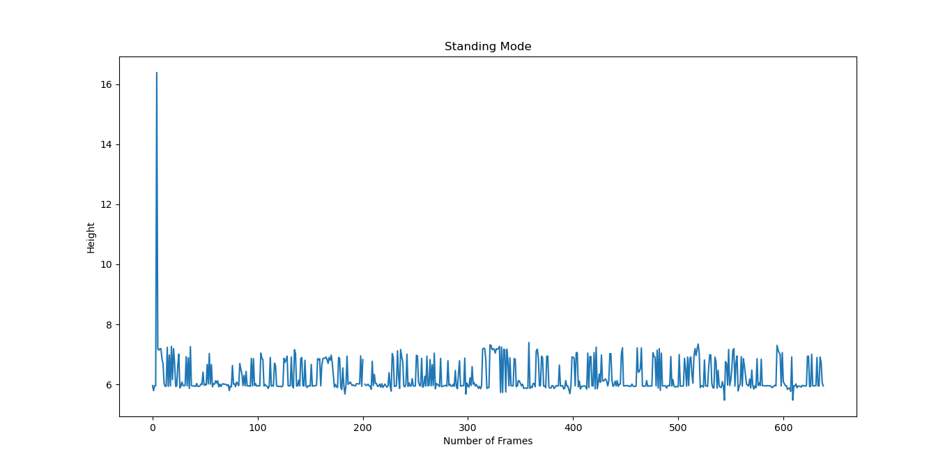

Attached here the height series data captured for different frames
Here I am still seeing that height of each frames are getting fluctuated. I wanted it to be normalized.
Queries to be clarified
1. Which Average height detection model is used in Fall detection experiment. Please elaborate.
2. Even person sitting idle / standing idle, Why i am seeing the fluctuation in height data. Is my height detection formula is correct ? ( Distance  = 3D points distance bw highest and lowest point of a frame)

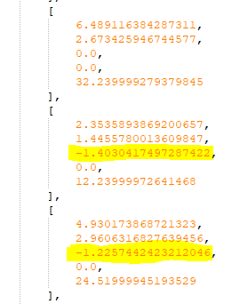

    Currently I am mounted the sensor on the wall , which is 1.6 m from ground and tilted 10 degrees.
    As you mentioned that Z will be point for Height. I have sorted the Point cloud array with Z direction and got the sorted array in Z basis.
    Here I have a question.
    Query#1
    If Z is the height, why I am getting Negative values for in Point cloud data even though person is in Standing Mode, Sitting mode.
    As suggested, I have also tried by applying Z filter to Point cloud data, From which I have calculated the height using highest and lowest point; checked the frame series vs Height data. But still I am seeing fluctuations in the Graph. Attached here for your reference.
    Query #2:
    If Z is height of the person, While person in Standing or Sitting mode, why this much spike I am getting? How should I refine this.
    As recommended by you in the previous thread, I have also tried by calculating the height of the target using Sensor height. This is the serious of data observed in various mode.

  • Hi Vivek,
    #1 - Why is Z negative? Z is the point position relative to the sensor. So if the person is below the sensor height (or part of their body is below the sensor height), then there will be negative Z values.

    When I tried to calculate the height with Z points , I am getting spikes and deviation across frames. And like shown in experiment I am not able to differentiate the height in Sitting and Standing mode.
    With your approach (Height = Sensor height - Highest Z value of a frame), I have tried it. This is the height series graph

  • Hi Vivek,
    2. After testing this on my own side, I have found that these spikes are common, as the point cloud tends to "jump" across the person. So one frame it may detect mostly your head, then the next frame detect mostly you feet. This leads to strange height measurement. I recommend using the LRPD demo, with a configuration for short range detection. This will give more consistent results.
