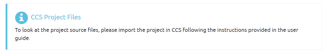

  • In the user's guide page 10, step 2, neither the MSS nor DSS projects can be imported, instead I get a message "To look at the project source files, please import he project in CCS following the instructions provided in the user guide." I must be following the wrong user guide? I have tried the latest version of the industrial toolbox, V4.3.0, and V2.0.0. V2.0.0 allows me to load the project, but I get errors with paths not being valid.
  • Dear Clint:
    The following will allow you to import the MSS and DSS projects:
    Once you are in CCS right click in the Project Explorer: Import -> CCS Projects:
    Then use the following path:
    <Industrial Toolbox Install Path>\labs\out_of_box_demo\16xx_mmwave_sdk
    This should import both mss and dss projects into the CCS Project Explorer.
    Connor Desmond
  • Thanks, that did indeed load the both projects.
    Now to get them running! Should I be getting errors when performing a build on those projects? Am I missing something?
