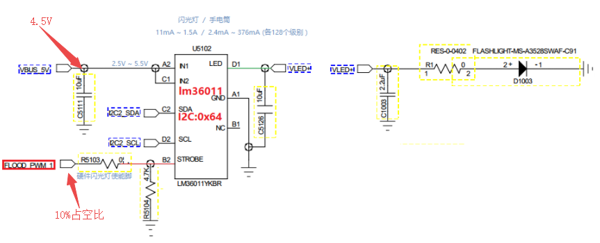

im36011 can't set register 0x01 bit 0 and bit 1
Other Parts Discussed in Thread: LM36011
In IM36011 datasheet, there are there modes(flash mode / torch mode / IR mode) than im36011 can work on.
Activated by the enable register (0x01), setting mode M1, M0(bits(1:0)) to corresponding vale.
As a matter of fact, im36011 can't set register 0x01(bits(1:0)).
How to change the working mode?

  • Hi Carl,
        Reg 0x05 is the fault regs which indicate the fault status of the devices. Please don't write any data to this reg and try again.
    BR
    Sean
  • Hi Sean.
      I sent reg0x01 to 0x22(defult is 0x20), then read reg0x05,  0x05 value change from 0x00  to 0x20.
    BR
    Sean
  • Hi Carl,
        Have you connected the LED when you do the test? This is really strange and you can try with another device.
    BR
    Sean
  • Hi Sean,
        Yes, we have connected the LED when we do the test。Other device with the same test result.
        Please help to check the hw design.
    BR
    Carl
  • Hi Carl,
        Please remove C5126 and C1003 from the schematic.
    BR
    Sean
  • Hi Sean,
    After remove C5126 and C1003, reg 0x01 can set to 0x02, reg0x05 read is 0x00(OK).
    But reg0x01 set to 0x02, reg0x04 set to 0x1F,  reg0x05 read is 0x00, It still can't work as Torch Mode.

  • Hi Carl,
         The regs setting is ok, you'd better try again and test, it is really strange with your description, it should work with those regs setting.
    BR
    Sean
  • Hi Sean.
    Thank you very much!   After remove C5126, reg0x01 can set OK.
