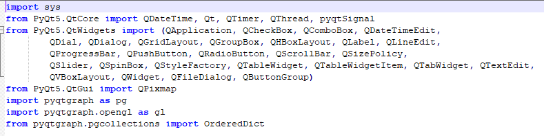

Dear Agate:
To find all of the relevant python GUI code use the following path:
<Industrial Toolbox Install Path>\labs\people_counting\visualizer
Everything that you need should be there.
Connor Desmond
Dear Agate:
One way to create a PyQt GUI is to use a .ui file. The other way is to construct the GUI purely in a .py file. This was what was done for the people counting demo. There is no .ui file. Attached is the directory location for the visualizer that will give details about it.
<Industrial Toolbox Install Path>\labs\people_counting\visualize\docs\ba_visualizer_user_guide.html
Connor Desmond
