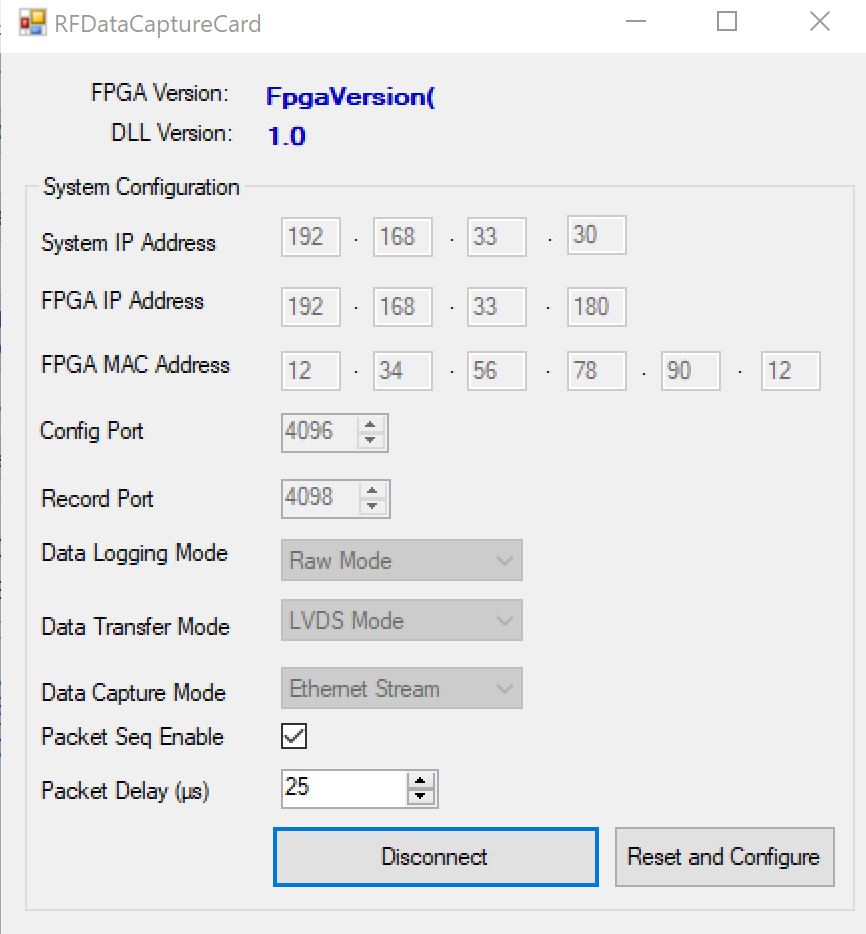

I am having trouble capturing data from a AWR1843 using mmWave Studio 2.1.0.0. I am following the startup guide and get to the step to set up the DCA1000 and do not get the correct FPGA version.
According to the output log shown below, the DCA1000 is not receiving UDP messages. Please help.

[05:28:12]  [RadarAPI]: ar1.GetCaptureCardFPGAVersion()
[05:28:12]  [RadarAPI]: Sending fpga_version command to DCA1000
[05:28:12]
[05:28:12]
[05:28:12]  ReadRFDCCard_FpgaVersion(): UDP recvfrom failed : 10052
[05:28:12]
[05:28:12]  Unable to read FPGA Version. [error -2]

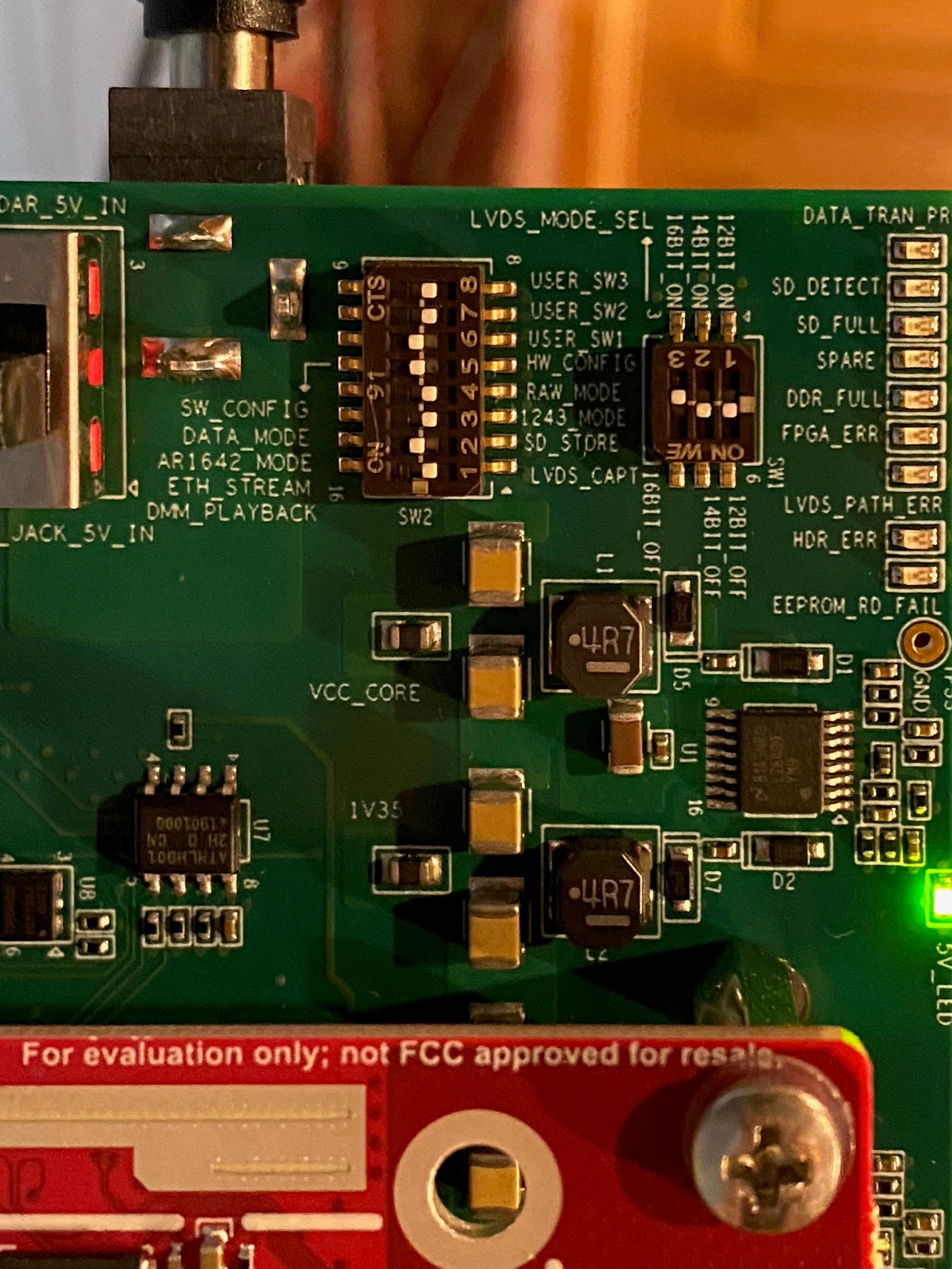

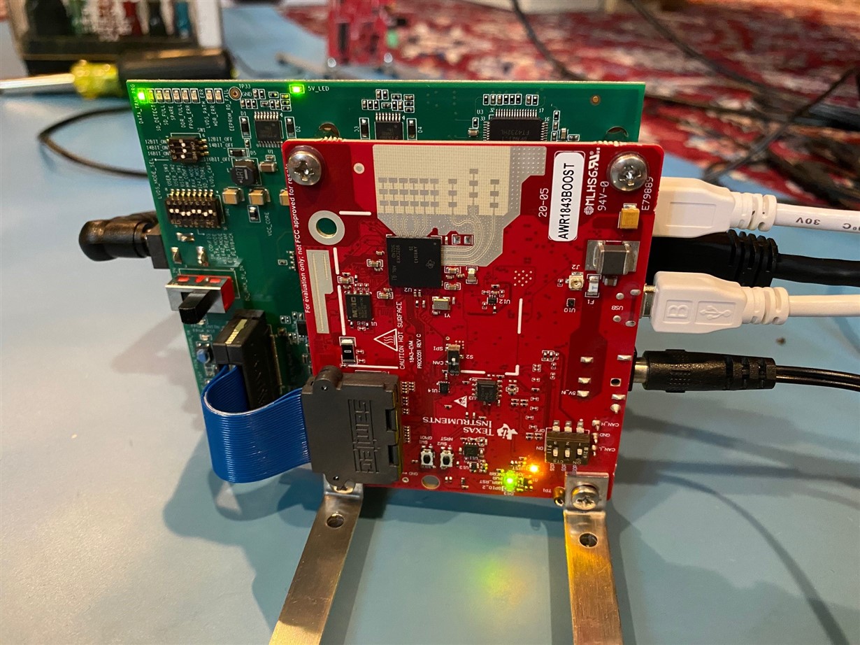

    - Can you try the procedure in previously linked thread to see if data is being received at 192.168.33.30 and provide the results?
    - Can you provide photo of your board setup to verify that everything is ok there?
    Amanda
  • Hi Amanda,
    I have downloaded Wireshark and it appears to be working, but I do not have a 1 Gb switch at hand (working from home is a pain). I will see if I can track one down this afternoon.
    Photos of setup are below.

    Hello Joe,
    This is surprising, does the data actually make sense? Looking at the output messages I'd expect that the adc_data.bin file does not contain meaningful data. What happens if you delete the adc_data.bin file and try recollecting the data?
    Amanda
  • Hi Amanda,
    The file does appear to contain meaningful data and it was generated this morning, but now I cannot get it to produce another one. This is rather odd. I tried to attach the file but a get an error.
    Joe
