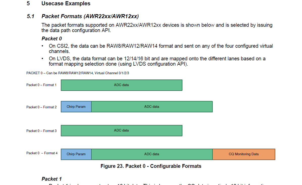

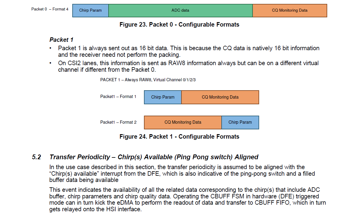

In the AWR1xx and AWR22xx Data Path Programmer’s Guide.pdf there is something talk about Packet Formats (AWR22xx/AWR12xx) in 5.1.I don’t understand what it means.
1. Is packet1 necessary?And is packet1 after packet0?
2.Are all the data collected by AWR1243 packaged and then output for signal processing?Is the data collected by AWR1642 also packaged and output?
Waiting for your reply.thank you.
