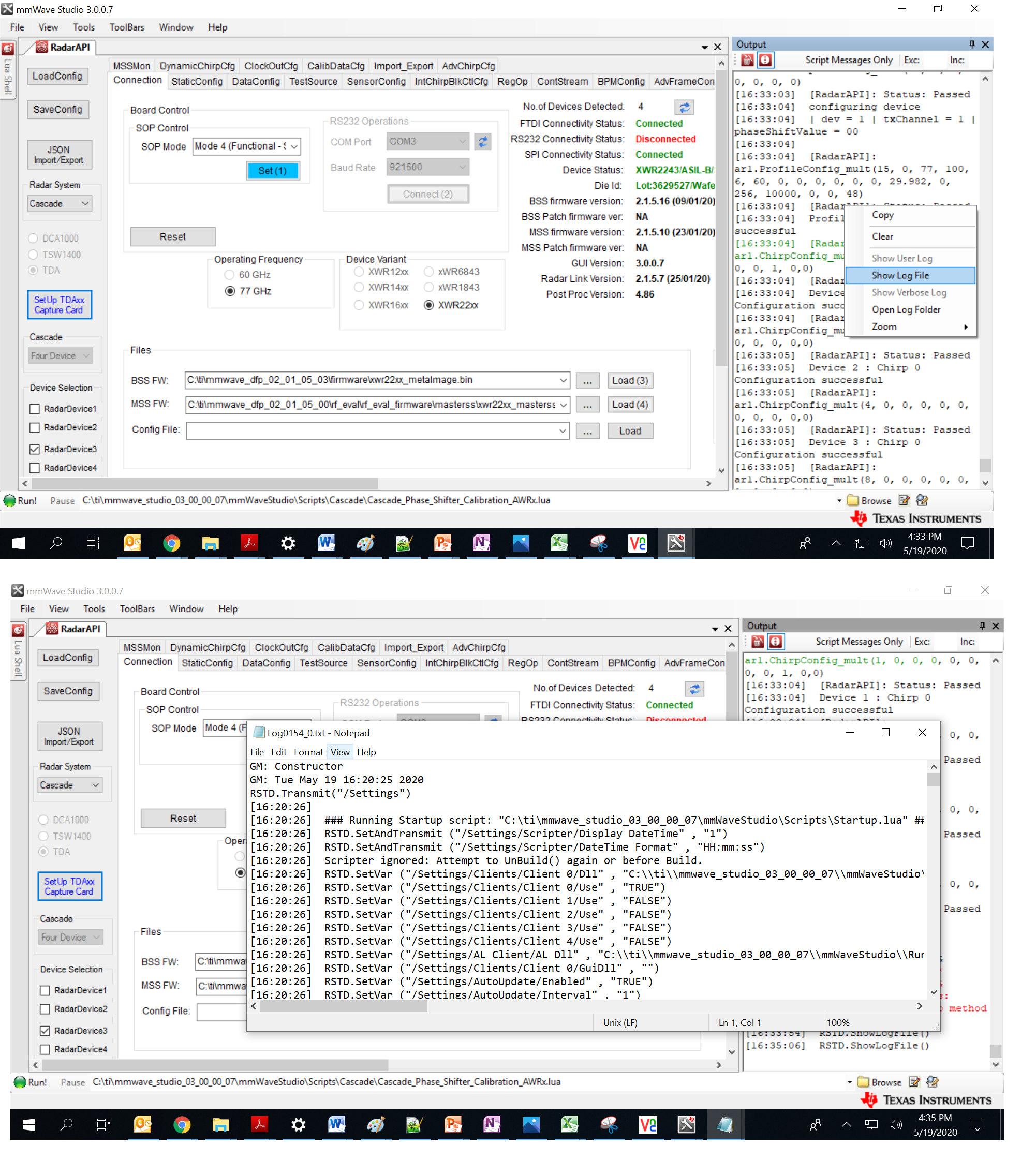

  • Hello Stelios,
    I saw the images of your setup, and it looks good as of now, but I was not able to download the log file.
    Below are the instructions to capture the mmwave studio log file, and then you can save it as a text file and send it over as an attachment. Could you please follow them and send the log file like this?
    Step 1: right click on the mmwave studio output log as shown below, and click "show log file"button
    Step 2: The log file would appear as a text file, save the file.

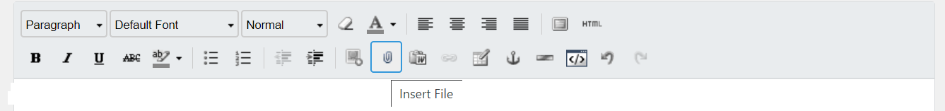

    Step 3: Click on the attachment button as shown below to insert the file.
    Thankyou for your effort.
    Ishita

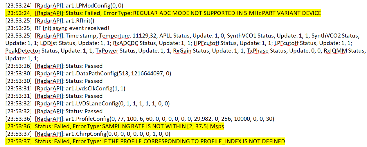

  • Dear Ishita,
    thank you again for your reply - I appreciate your help.
    There are multiple log files at the PostProc folder of the MMWAVE-STUDIO. There are even two figures (a fig and a png file).
    But for now, please find attached the log file that I generated by following your instructions. Please let me know if you would also like me to upload all the aforementioned log files as well.
    Stelios

    [23:53:22]  [RadarAPI]: ar1.ChanNAdcConfig(1, 1, 0, 1, 1, 1, 1, 2, 1, 0)
    [23:53:22]  [RadarAPI]: Status: Passed
    [23:53:24]  [RadarAPI]: ar1.LPModConfig(0, 0)
    [23:53:24]  [RadarAPI]: Status: Failed, Error Type: REGULAR ADC MODE NOT SUPPORTED IN 5 MHz PART VARIANT DEVICE
    [23:53:25]  [RadarAPI]: ar1.RfInit()
    [23:53:25]  RF Init async event received!
    [23:53:25]  [RadarAPI]: Time stamp, Temperture: 11129,32; APLL Status, Update: 1, 0; SynthVCO1 Status, Update: 1, 1; SynthVCO2 Status, Update: 1, 1; LODist Status, Update: 1, 1; RxADCDC Status, Update: 1, 1; HPFcutoff Status, Update: 1, 1; LPFcutoff Status, Update: 1, 1; PeakDetector Status, Update: 1, 1; TxPower Status, Update: 1, 1; RxGain Status, Update: 1, 1; TxPhase Status, Update: 0, 0; RxIQMM Status, Update: 1, 1;
    [23:53:26]  [RadarAPI]: Status: Passed
    [23:53:30]  [RadarAPI]: ar1.DataPathConfig(513, 1216644097, 0)
    [23:53:30]  [RadarAPI]: Status: Passed
    [23:53:31]  [RadarAPI]: ar1.LvdsClkConfig(1, 1)
    [23:53:31]  [RadarAPI]: Status: Passed
    [23:53:32]  [RadarAPI]: ar1.LVDSLaneConfig(0, 1, 1, 1, 1, 1, 0, 0)
    [23:53:32]  [RadarAPI]: Status: Passed
    [23:53:36]  [RadarAPI]: ar1.ProfileConfig(0, 77, 100, 6, 60, 0, 0, 0, 0, 0, 0, 29,982, 0, 256, 10000, 0, 0, 30)
    [23:53:36]  Status: Failed, Error Type: SAMPLING RATE IS NOT WITHIN [2, 37.5] Msps
    [23:53:37]  [RadarAPI]: ar1.ChirpConfig(0, 0, 0, 0, 0, 0, 0, 1, 0, 0)
    [23:53:37]  Status: Failed, Error Type: IF THE PROFILE CORRESPONDING TO PROFILE_INDEX IS NOT DEFINED

  • Hi Stelios,
    As I can see from your studio log, the highlighted configurations failed when you issued the APIs.
    1. Regular ADC mode is not supported for the device variant you are using, you have to use low power mode in this case.
    2. You profile and chirp configuration failed, because of which there were no chirps issued for capture. Hence, your issue is not with DCA1000, but with the configuration. Once you are able to configure the chirps properly (status : PASSED), you would be able to capture the data. I request you to cross check your configuration once.
    Just make sure to see the status of the API whenever you issue one in mmwave studio.
    I hope I was able to help you solve your problem. If you need any more clarifications, please feel free to ask.
    Ishita
  • Yes, it seems that after correcting the sampling rate it does work! Thank you very much!
