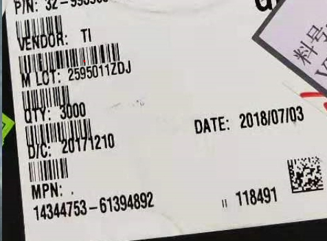

  • Hi Brandon
    Our meters are Rotronic HygroPalm HP21(accuaracy: ±1%RH) and Testo 175H1(accuaracy:±2%RH).
    These parts D/C is 20171210. And We had check with manufacture that these boards had never been washed. And we also checked the Chemical material in the list of datasheet, but none of them are used in the production process of these boards.
  • Hi Jason,
    After thinking on this more, the fact that you are seeing humidity values about 80% makes it so any shift on the HDC2010 would be positive, so even if the applied offset was an overshoot for some parts, it would not push them outside your application limits. These parts being from the same reel also makes it more likely that they would have shifted together during any storage.
    I would recommend applying your 2.5% calibration. You can use register 0x09 of the HDC2010 register map for this purpose if you would like.
    Brandon Fisher
