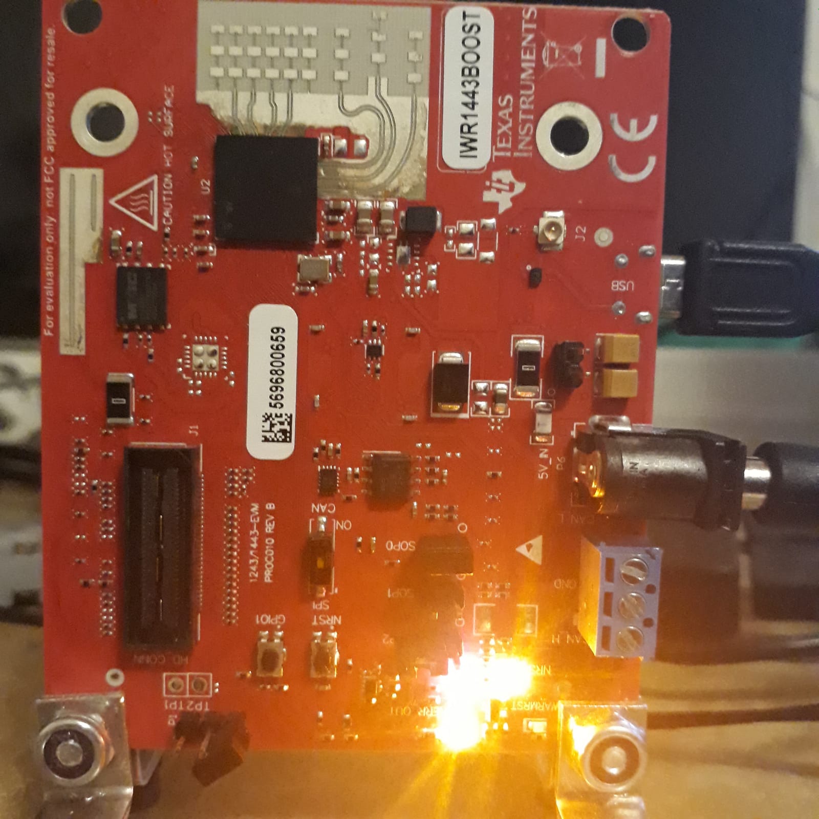

I bought from the Internet this IWR1443BOOST hardware. I want to develop object detection software.However, I cannot do any thing. I spend thousends of hours but I have many issues. First of all, I installed over 3 gbyte and many software versions. Finally, it is working. Secondly, I cannot put in normal run when I use Code Composer Studio.
TEXAS I AM SAYING TO YOU, Please send me one example code with works my IWR1443BOOST and explain which version to use. I want to use this radar and develop object detection system but you cannot give clear information and knowledge on your forum .etc.

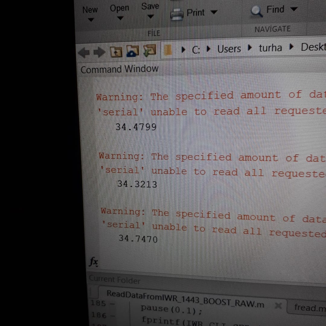

  • I read all of them but still is not clear. Could you connect to my computer and I can show you what I have problem this will take many days. I am trying to collect data about 1 year. However, it is not okay for me. Still I don't have reliable data.
    Now I am reading L3 but always it is changing. There is not good euclidean distance between the arrays.

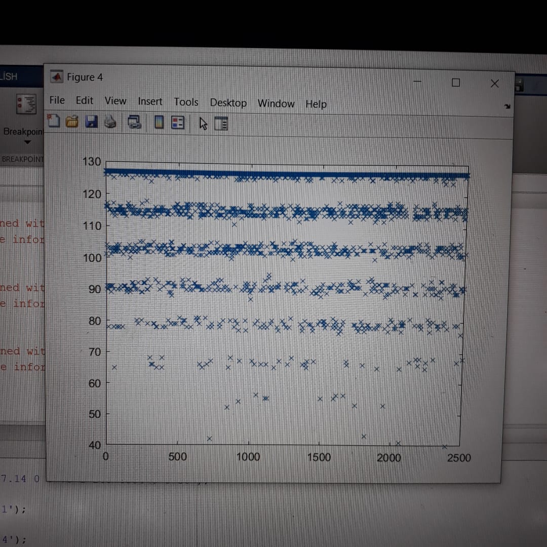

     I am reading gMmwL3 data and sending to matlab to process it. However, look the attachement I don't have any same data frame they are always changing among them. I am taking distance between two matrix and the result are %70 different.
  • Former Member
    0 Former Member in reply to turhan kumrallar
    I don't understand what the axes in your plot is supposed to represent - can you clarify?
    But I think you're saying you are getting variable output. The problem is you have enabled the detected object list output in the guimonitor command. This means that size of the output packet for each frame will vary with the number of detected objects in that frame. You should disable the output if you don't need it.
    Amanda
  • Did you check the code?  I am reading directly L3 memory.  Axis is array index.
