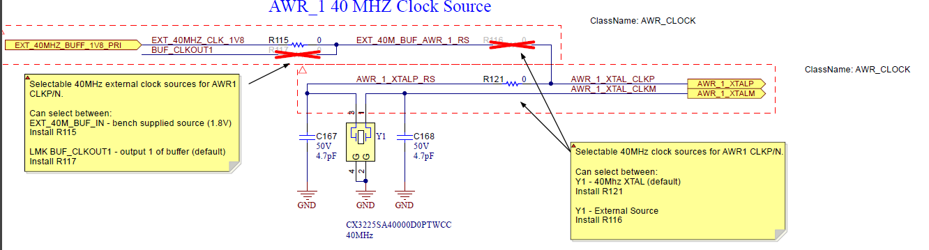

  I am from SAIC MOTOR of China, We meet one issue about imaging Radar model (TIDEP-01017- MMWCAS-DSP-EVM, TIDEP-01012-MMWCAS-RF-EVM), the issue is the TIDEP-01012-MMWCAS-RF-EVM can not receive 40MHz CLK signal from TIDEP-01017- MMWCAS-DSP-EVM, which result in imaging Radar model can not work。

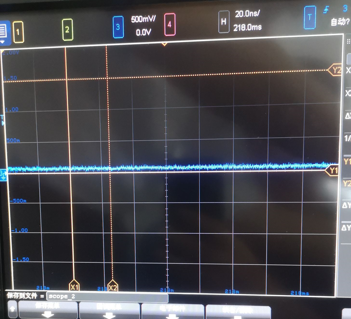

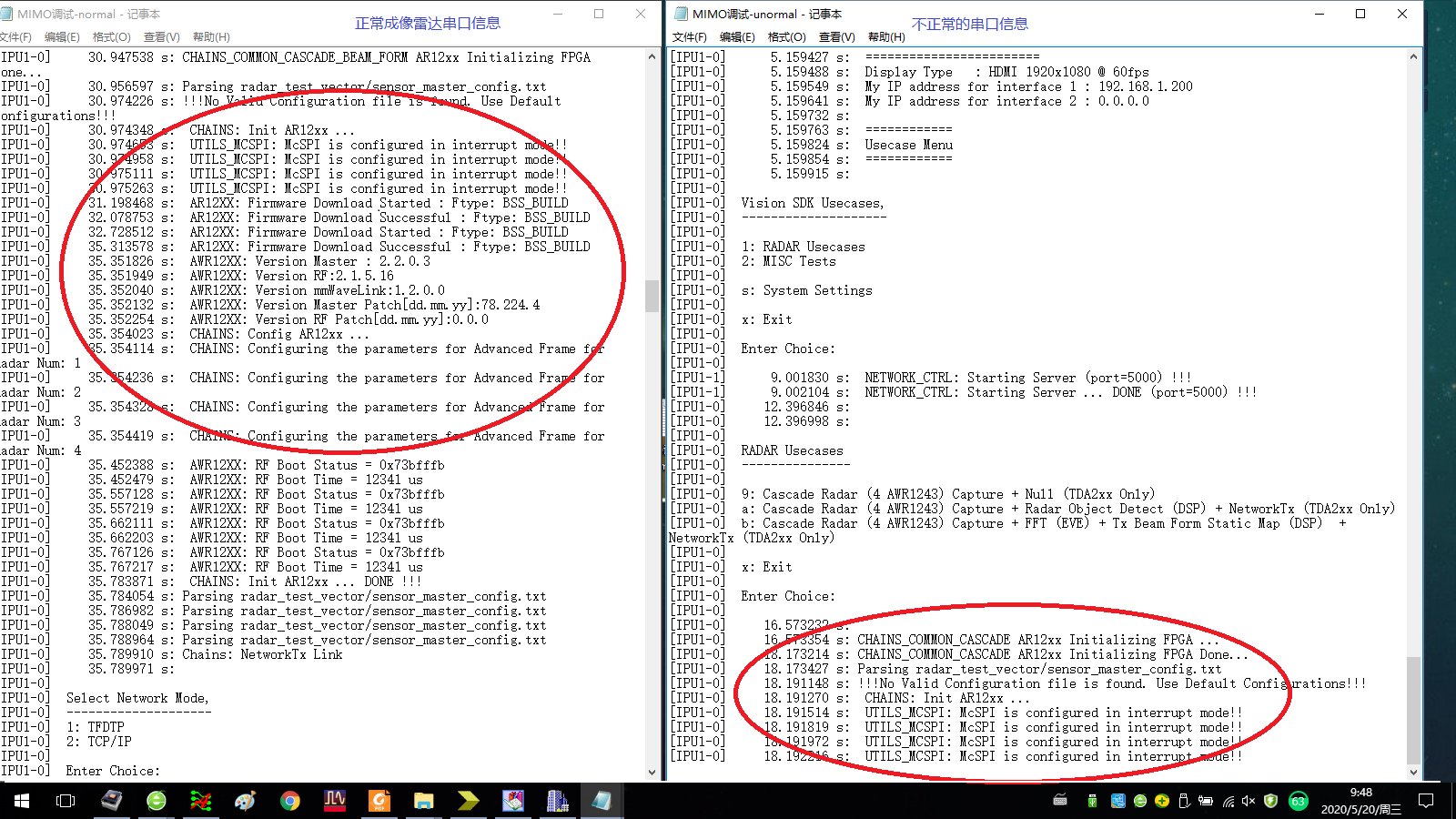

  we have do some troubleshooting analysis, from the attachment (Difference between normal and unnormal of UART print information about TIDEP-01017),we get the difference between normal and unnormal of UART print information and learn that the issue is caused by the failure of AWR1243 chip downloading firmware, which is result from without 40MHz CLK signal input for AWR1243. the attachment contains 40MHz CLK signal and  DC signal (unnormal CLK)
