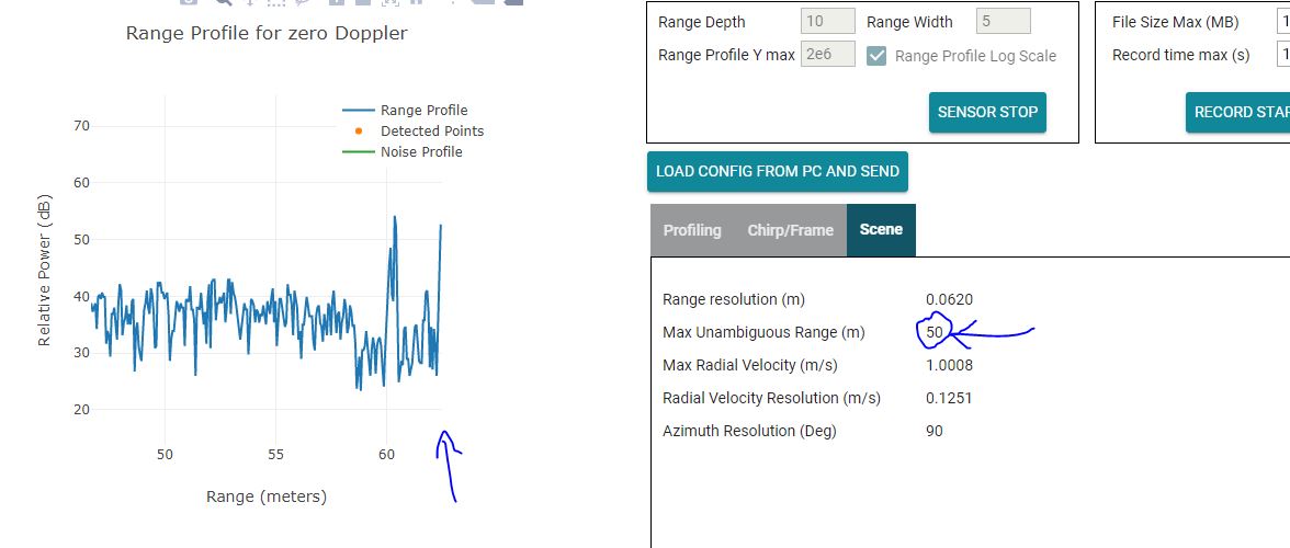

  • Very clear. Regarding 3). I send a configuration to the IWR1443 from which mmWave_Demo_Visualizer estimates a maximum unambiguous range of 59 m, but the maximum value on the x axis of the range plot is ca. 63, see image below, where both values are highlighted. I think that maximum unambiguous range is computed as Maximum IF bandwidth x speed_of_light / (Slope*2). While the max value on the x axis is the number of bins multiplied by the range resolution (ca. 1024*0.0662=ca. 63).
    Is it deeply not suggested to measure range beyond the maximum unambiguous range because of what you refer to as distortion? Because typically we measure in the range interval 50-60 m.
  • HI, Filippo:
    What is the IF bandwidth and ADC sampling rate in your configuration?  50 vs 63, the difference is little bit larger than I expected. I thought it will be 90~95%.
    Can you provide your complete profile/chirp configuration?
    Zigang

  • HI,
    It seems that in the document here http://www.ti.com/lit/an/swra553a/swra553a.pdf, 90% of the ADC sampling rate is used for maximum IF bandwidth.   But in the visualizer 80% is used for maximum IF bandwidth.
    I am still discuss with the team to figure out which one is recommended.
    Zigang
  • HI,
    We have an internal discussion, and 80% is the right value.  The datasheet always lists the IF bandwidth as 80% of the ADC sampling rate.
    Zigang
  • Dear zigang,
    I fully agree with you: 80% of ADC sampling rate is used to calculate max unambiguous range. But my question was: the mmWave_Demo_Visualizer in the plot range shows values up to 64 m on the x-axis, so basically it shows range values up obtained by using the full (100%) sampling rate. Should value between 50 m (80% of sampling rate: unambiguous range) and 64 m (100% of sampling rate) be discarded because distorted? Best Regards
  • HI,
    The information between 80% ~ 100% will not be reliable due to the aliasing effect.    It is better to discard this part or at least understand the possibility of aliasing effort.
    Zigang
