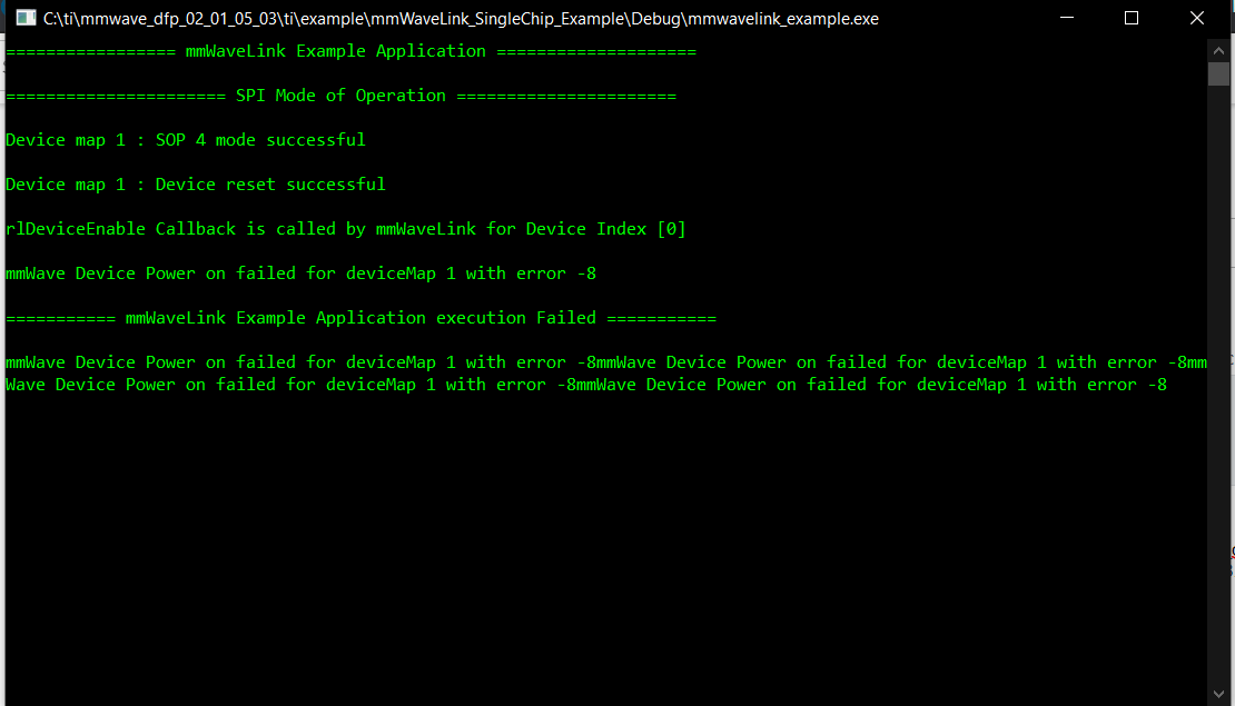

I am using the awr2243 boost evm. I am attempting to use the executable file created by compiling the visual studios project in the C:\ti\mmwave_dfp_02_01_05_03\ti\example\mmWaveLink_SingleChip_Example. When i do this and have the evm connected as explained in the procedure i get the error :mmWave Device Power on failed for deviceMap 1 with error -8. what causes this and how to i correct the error to move forward.

  • Hello Glen,
    Application resets the mmwave sensor and wait for Power On async-event message over SPI. As per error code, looks like it didn't get this async-event message within timeout.
    Make sure that you have connected AWR2243BOOST with either DevPack or DCA1000EVM board for this experiment. As SPI interface is available on DevPack/DCA1000 over which AWR2243 send/receive the response/command.
    And if this board is stacked with AWR2243BOOST then try with mmwave studio to verify all the connection.

    I took a break from this project but am back at it now. I am still having this same issue. I have went back and tried the mmwave gui and the board functions properly using the gui, but the exe application still fails on the power up with the same -8 error code. The awr2243 is connected to the DCA1000 and has the ribbon cable connecting them and all necessary usb's and ethernet cable connected to the host pc. Any other suggestions to make this example application execute properly?

  • Hello Desi,
    Somehow exe application is not able to reset the board (which further generates the powerup async-event).
    Do you see Red LED (NRST_OUT) on AWR2243BOOST blinked when you execute the application?
    If not then try pushing the NRST switch button on the board and immediately execute the application.
