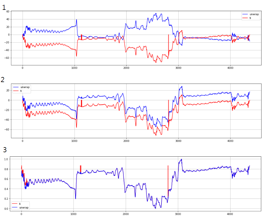

picture 1.
  Q1. Why does it look upside down?
picture 2.
  Q2. Why are the scales different?
picture 3.
  Q3. Why are the beginnings different?
  Q4. Why does the middle part bouncing?

  • Blue is the graph where we unwraped the bin's img and real values.
    Red is unwraped from mmwave firmware.
    The two data are from the exactly same bin and same time.
    Picture 1 is after unwrapping with the python code.(blue)
    Picture 2 is the picture that flipped the unwrapping data.(blue)
    Picture 3 normalizes the two data.

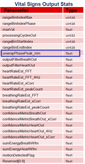

    The red line is unwrapPhasePeak_mm sent by mmwave.
    The blue line unwarped the Range-bin's img and real values using the unwrap function we converted to Python code.
    Because only one range-bin is enabled, two data(img and real values, unwrapPhasePeak_mm) are from the same range-bin.

  • HI,
    Here is the reply from our design expert:
    The 2nd and 3rd parameter of the unwrap function   unwrap(float phase, float phasePrev, float *diffPhaseCorrectionCum) depends on the phase values from previous frames.
    When the user is implementing his own function in Python these previous phase values probably do not match with what the real-time code would be using.
    For example when the user starts saving the UART data (by checking the Save Data checkbox on the GUI) the data might have started saving form frame 10 (as an example) so the user’s initial phase value is from frame 10 in offline processing in Python while in the red curve (the output from the variable unwrapPhaePeak_mm) the initial phase value is from frame 1.
    The shape of the waveforms are the same. I don’t think the differences in the offset/scales make any difference in terms of the algorithm.
    Hope it explains what you see.
